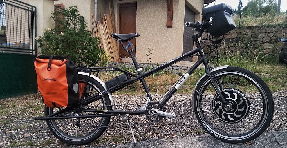

Simplified 2WD Wiring with 1WD/2WD Control
It seems there has been a flurry of 2WD interest recently -- I've gotten some PM traffic on the subject and there are also a couple of notable builds underway:
  • Teslanv has a dual DD 2WD Luna build with the identical single-throttle/single-CA-V3/external-shunt configuration that I used here.
  • Alan B is pursuing an interesting build here that has promise for some spiffy active control.
  • A completed and impressive 2WD build, The Duty Cycle AWD, uses the same equal-gearmotor/controller/magura throttle setup as this build.
  • The final urging came while this post was hanging out as a draft when teslanv posted up a a complete wiring diagram for his 2WD DD bikes here :) .
This provided some motivation to distill some of the basic 2WD information from this build into a single post. The idea is to describe an equivalent but simplified build HowTo that focuses on only the 2WD wiring and control aspects without the 'extras' (DC/DC converter, etc).
The basic parallel power/throttle wiring scheme is as described briefly in "4.2.1.6 Installation with Multiple Controllers (2WD)" of the CA V3 Unofficial Guide. This build departs from that basic strategy primarily in the 1WD/2WD 3-power level switch integration to give more operational flexibility.
Build Overview
  • Controls and Other Stuff
    1. The CA V3 is an integral part of making the bike drivable. It provides throttle ramping to protect the motor clutches, Power Throttle for smooth control, 3-speed power restrictions in 1WD or 2WD modes, and integrated PAS using either 1WD or 2WD.
    2. The CA uses a front wheel pickup so that proper speed/distance reporting is not dependent on a single motor (hall). This allows the controller to be powered off completely with the kill switch and pedaled normally while the CA remains active with the wheel pickup as a viable signal source.
    3. There are 3 'standard and one 'extra' control that are readily manipulable on the bars:
      • a single throttle,
      • a three-speed switch,
      • the familiar kill switch, and
      • 1WD/2WD switch. <<== the 'extra' control
      An auxiliary switch on the dash determines if '1WD' means FWD or RWD - not used often so not necessary to put at the fingertips. 2WD mode provides twice the power as 1WD. The three-speed switch provides roughly 100%/66%/33% power in either 1WD or 2WD mode so the are really six power levels in total. Basically, you drive it like a regular ebike and the throttle and 3-speed switch just work the way you'd expect regardless of whether you are in 1WD or 2WD mode. Simple - no special learning required.
    4. The bike is designed on the idea of equal wheels/motors/controllers splitting the load and power 50/50. It operates and handles well with this 50/50 split and the result is significantly simplified control electronics - none. Other strategies are certainly possible, but this approach works well and is simple to implement. With the same Kv and performance curve for all situations, the motors are always operating equally with the same efficiency.
      In general it can be useful to see the two motors as geared together 1:1 through the wheels and road - essentially two motors on the same shaft or one motor with a stator twice as wide.
    5. The controllers were specifically programmed to provide very similar power using inclined testing to enforce the 50/50 split concept for getaways. They are set to run only to 99% PWM - the Infineon 100+% modes are not used.
      Some adjustment of controller limiting is possible to unbalance the 'equal power' concept. This would take effect only when the motors are controller-limited - basically acceleration and heavier load (eg hill-climbing). General cruising on the flat sees the motors running without controller limiting where such adjustments have no effect.
    6. Motor and CA 'contention' reported in some threads is not detectable. This is likely due in part to the modest power, specific wiring practices, controller programming, and use of the CA internal 5V supply to drive the throttle. There may also be an effect from the freewheel clutches mechanically de-coupling the motors to some extent if one overruns the other.
    7. Only the front motor has temperature monitoring. Again, owing to the 50/50 power division there is no reason to believe there will be materially divergent motor temperatures. External temperature tests with infrared and point-of-contact thermocouples support this view. This works well with the V3 which has but a single temp input and so uses the front motor temperature to throttle back power to both motors in 2WD mode.
  • Generic Version of Wiring and Controls
    1. Particular attention was paid to the wiring and ground practices. In addition, the CA is an integral component in that it provides a separate 5V supply for the throttles that is largely independent of either controller ground reference (DC bias and noise issues)
      • The CA uses an external shunt to give unified power management for both motors. This also separates the CA ground from the controller grounds. The Ground wiring from the external shunt is actually a bit long on this bike but should be kept as short as possible. Although the effect might be small, the wiring from the shunt to controllers is of equal length in an effort to ensure the controller ground references are the same.
      • No controller signal grounds are tied to the CA or to each other in any way. This avoids ground loops and is necessary to preserve the CA ground reference voltage as that of the external shunt. Specifically:
        • No throttle/ebrake/etc Gnds are connected at all (just the signal wires) - all signal the Gnd references are drawn entirely from the controller and CA power wiring.
        • Although the Throttle Override signals are used from the controller CA-DP connectors, no other CA-DP signals are used - Gnd, Vbatt(+), and shunt connections are specifically left unconnected.
        • The front motor thermistor uses a dedicated Gnd instead of sharing it with the halls as is frequently done.
    2. Below is a simplified version of the main wiring. There is nothing unusual - power is simply paralleled to the dual controllers and fed through the common CA external shunt. Although the CA molded shunt is rated at 50A, the back is sanded flat and it is bolted to an aluminum heat sink. It operates reliably at 60A and has been run higher.
    3. The throttle is driven from the CA +5V supply and the CA Throttle OUT drives the two controllers in parallel. The CA instead drives the controller throttle inputs directly instead of using the controller throttle Override connections at the controller CA-DP connectors.
      The controller CA-DP Throttle Override connections are used to control 1WD/2WD instead of providing CA V3 throttle input as is normally done. Both controllers are always powered up and 1WD/2WD is implemented by overriding/suppressing the controller throttle inputs in exactly the manner of a CA V2 overriding the operator throttle - by 'limiting' it to ZERO. So, here a switch limits the CA throttle instead of the CA limiting the operator throttle... The two controller CA-DP Throttle Override inputs are either or neither shorted to ground as appropriate to disable one or neither controller throttle inputs - the result is that either both throttles work (2WD) or one of the throttle inputs is suppressed (FWD/RWD).
    4. Here is a simplified version of the scheme used on this bike with a 1WD/2WD handlebar thumbswitch and a dashboard 1WD F/R selection switch. This very convenient and easy to work with gloves. (Again, cogging losses may make the 1WD operation provided by this control design of questionable value for DD builds, but that's another issue...)
    5. Below is a variation with a combined FWD/2WD/RWD switch (ON-OFF-ON). This would work well with a rocker switch because the center position is easy to hit. If using toggle switches, the two-switch approach above is better since hitting the center position on a toggle can be more challenging than on a rocker - with a simple sweep of the toggle the above approach goes to 1WD or 2WD without fussing.
      Although even the 'simplified' controls require a bit of fabrication effort, IMHO the flexibility and ease of use allow the bike to be quickly adjusted to best run in a variety of situations so there are no 'locked in' operating modes where a simpler 2WD bike might provide a less than optimal experience.
So - to sort of sum it up - My personal preference for 2WD is to front-end the controllers with a CA V3 and external shunt which solves a variety of noise and control issues at once by moving a lot of the 'dual controller' functionalities into the single CA - the controllers are run in 'dumb mode'. All the complexities of 'two of everything' sort of disappear and you get:
  • a third (CA) +5V supply distinct from either controller to operate throttle, ebrakes, PAS, etc
  • unified single throttle control
  • unified monitoring, LVC, and limiting
  • unified 3-position switch
  • unified ebrake cutout
  • unified proportional regen if using Grin controllers (you have to address the duality by other means if you have non-Grin controllers with regen)
  • unified PAS
  • unified temp monitoring (assuming the same drive front and rear)
After that, a little attention to grounding practice should keep controller interactions to a minimum.
Anyhow - that's some hints about how to reproduce the build and controls and some explanation of why things are wired as they are. Many aspects of the build are designed around a 'pedalable' bike with modest powered gear motors and may not be directly applicable to DD 2WD, but the reasons for the decisions are here to be evaluated for other applications... :D
