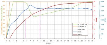

Performance
Skipping ahead to the result before plodding through the configuration details ;) we see the present (2WD/1WD switch) and (LHM switch) power matrix looks like this:
  • Caveat: With both motors engaged each sees one half the load from net vehicle weight, hills, and wind. Two motor operation substantially reduces motor stress and heating making 1-motor/High the most taxing setting (red cell in chart above). This mode is used only in case of a motor/controller failure (limp home mode).
Tests are plotted below for the red and green cells above. These three test runs were made last week at 45 degrees F with data collected by an Analogger at a 1Hz rate. The runs were made on a more or less flat and level stretch of bike path - each test terminated when the flat path section ran out - it was barely long enough. These are 'no pedal' runs with the throttle slammed WOT at a dead start. The plots show speed, power and how the CA manipulates the controller throttle levels.
Notice in each plot how the throttle (orange line) goes to WOT on startup and stays there but the CA ThrottleOut to the controllers (green line) drops to limit the power (blue line).
The plots show smooth and well-behaved speed curves (red lines) with no sudden changes in slope. The low end power is clearly restrained by the CA throttle ramping. The noticeable rise in the speed curve at the low-midrange is the effect of the high current configuration of the controllers - in this range they operate like dual 2200W units; at those speeds they are not drawing 4400W, but the bike experiences the strong midrange power curve of controllers of that power rating. Towards the top end, CA 3300W limiting takes over, holding peak motor power consumption down as the speed curve flattens out to a top speed of about 40mph. Under load on hills, the CA top end limiting just takes over sooner at a lower speed.

Configuration Details
Here are the relevant configuration parameters for the CA v3 (B19 firmware):
  • Code:
    Plim -> Max Current = [75.0] Amps
    Plim -> AGain = [110] Gain
    Plim -> Max Power = [3300] Watts
    Plim -> W Gain = [10] Gain
    ThrI -> Cntrl Mode = { Power (W) }
    ThrO -> Up Ramp = [32]
    ThrO -> Down Ramp = [400]
    Ctrl -> Aux Funct = { Power Lim }
Here are the Lyen controller configuration parameters:

  2. The controller/controller 'contention' was apparent when the controllers had identical default Lyen-style configurations. The interaction between the two controllers essentially disappeared when I switched to the cell_man controller programming technique and finalized the configuration as shown above with higher power, the 2:1 current ratio, and slightly dissimilar controller current settings. I was not actually attempting to address the 'contention' issue but something accidentally remedied the matter. Whatever the cause - a somewhat puzzling but welcome resolution…
In the end there is very rarely any sensation of 'contention' in either 1WD or 2WD modes. A faint interaction can very occasionally be detected under certain low speed high load conditions, but a minor throttle adjustment suppresses it. Not a problem ;)
Summary
The Lyen controller and CA V3 upgrade have worked out great and give the bike a nice production feel with very satisfying power and easy throttle control. It's extremely smooth off the line and requires no special care to avoid wheel spin or to protect gears/clutches. The bike tops out at just under 40mph, does 0 to 30 in under 10 seconds (150lb bike + 200lb rider), and zips up hills. The result is a really nice improvement over the original Crystalyte Analogs and CA V2. These changes took more effort than I had foreseen, but I am a very happy camper :mrgreen:
