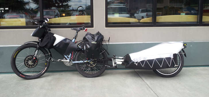

KF (kingfish) I believe that he uses a Waterproof membrane from the Plumbing trade to cover his triangle.
It's used for waterproofing custom showers basins. But buy the looks of his pic below, I could be wrong and
it was someone else I saw using the membrane. :)
If you like the "soft" look, KF did a really nice job!
