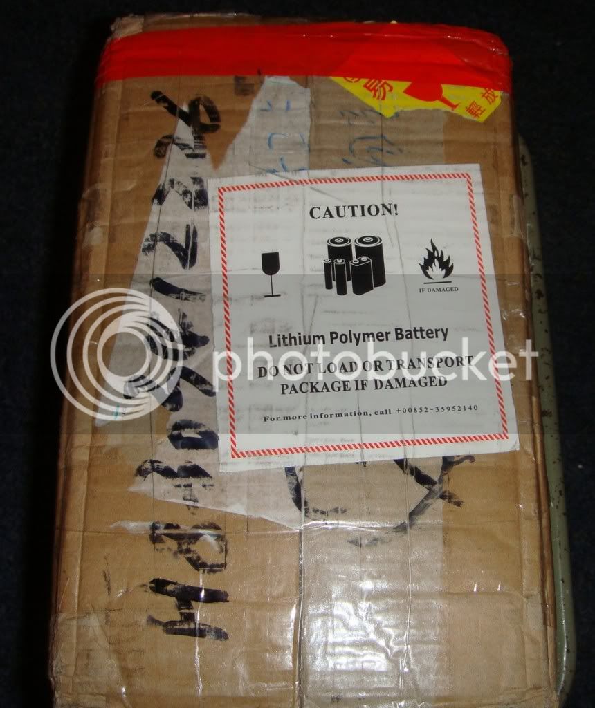

OK, so I'm ready to open the package, and the first thing I notice is this large warning label on the box. Check out what is says:
I swear I remember reading something about UPS won't ship dangerous lithium batteries or something like that, but there it is in huge letters that can't be missed about the dangers of the contents. But anyway, it got shipped and delivered, so maybe policies have changed.

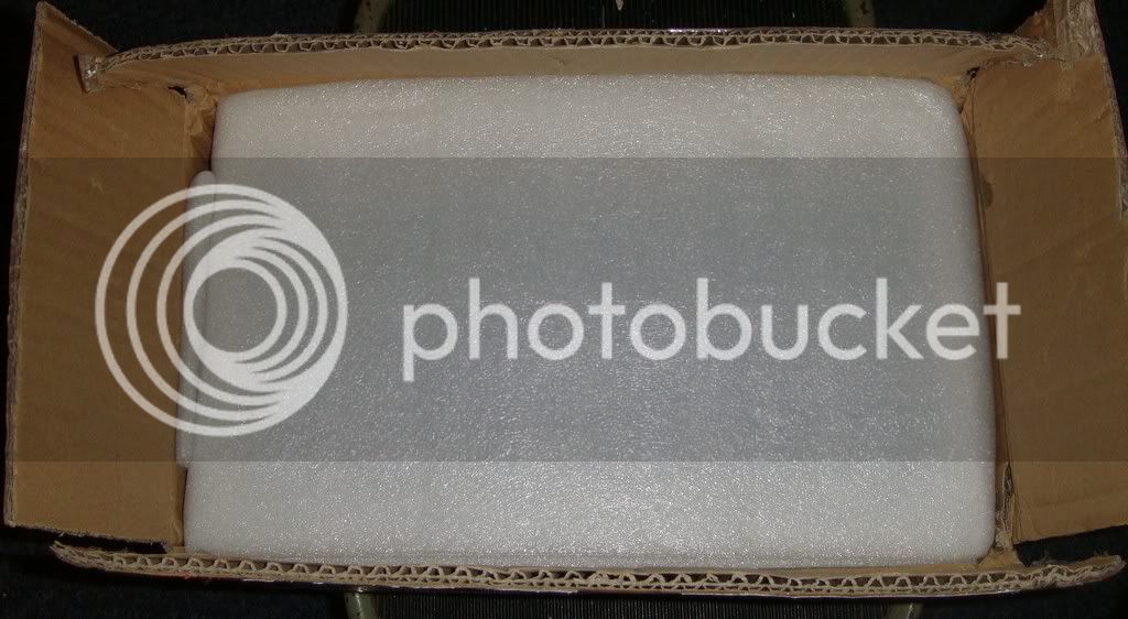

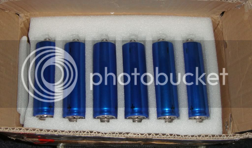

I open the top of the box, and see this:
I was impressed with the packing and the overall condition of the box when it got to me. I have had packages from Ping that were just beat to crap by the time I got them.

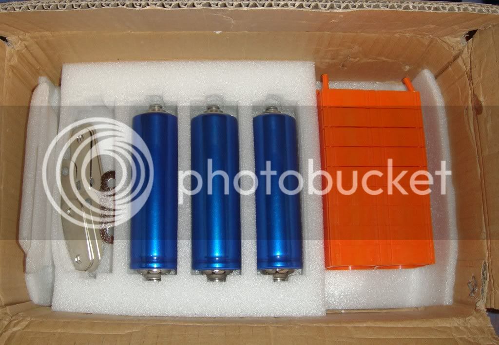

I peel back the first layer of padding, and see this:
Oh yeah, I like blue!! :wink:

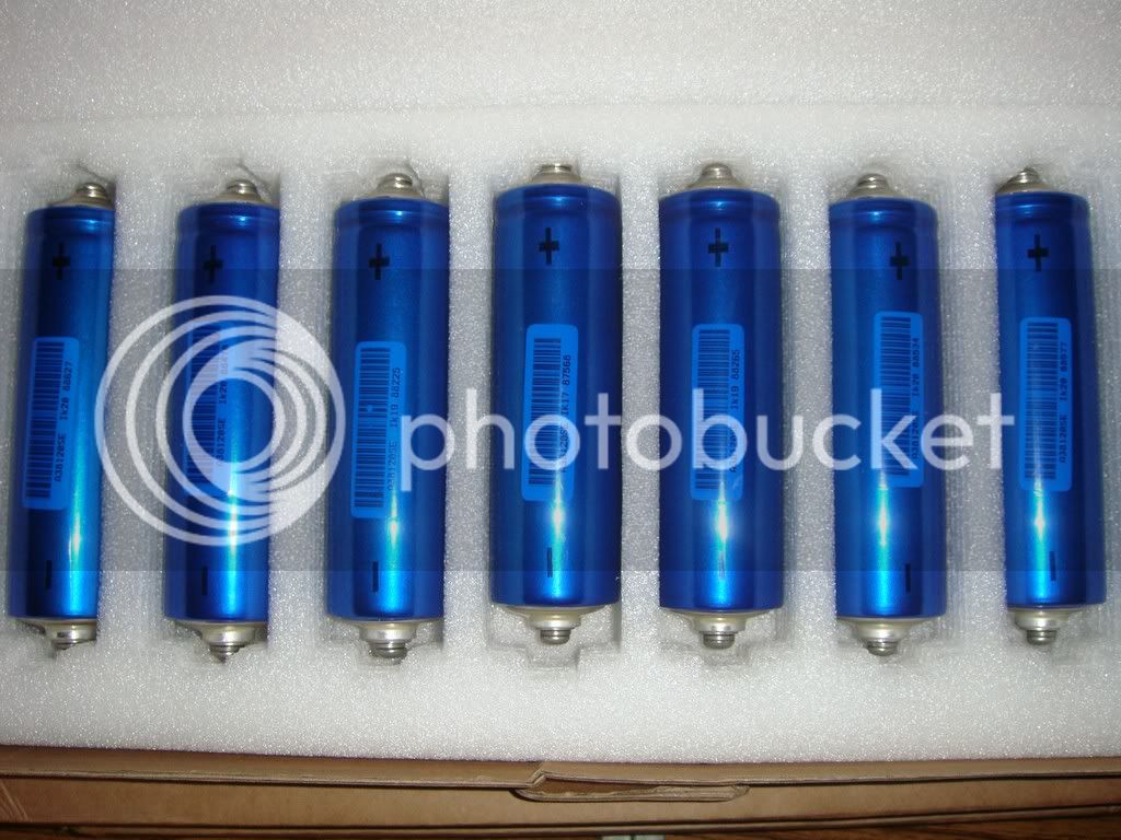

Under the first layer, was this:
They could have packed the building blocks a bit better, because as you can see in the photo, one of the little legs snapped during shipping. No biggie this time for me, because I will not be using them anyway. The buss bars were wrapped up good, I just unwrapped them for the photo. They weren't loose like that for the shipping. :lol:
Each cell was exactly 3.3v when they arrived. So, at this point, I'm going to put a single cell charger on each of them to bring them up to aprox 3.65v and see if any of them are going to be runts or anything. I'd like to get a CBA to test them with, and it might happen if I can get a CBA-I to work with Win7. I posted another thread about that, tho.

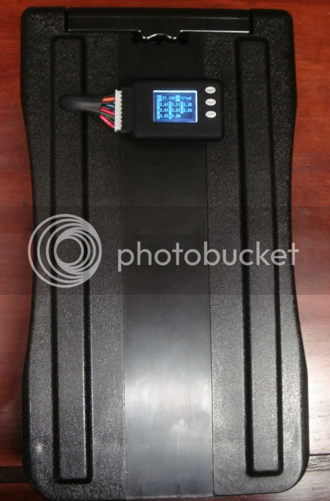

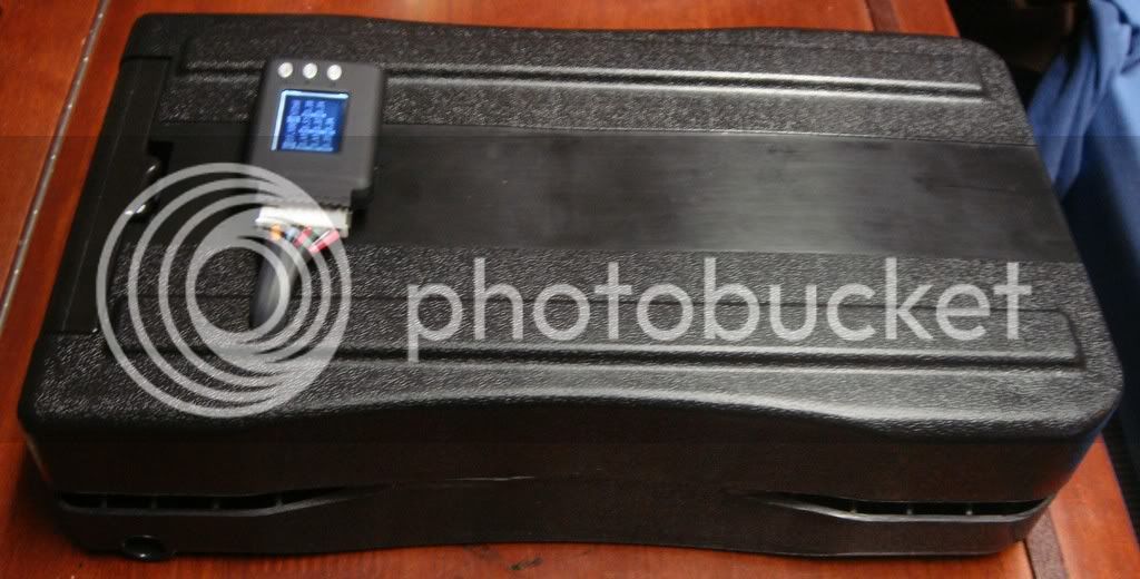

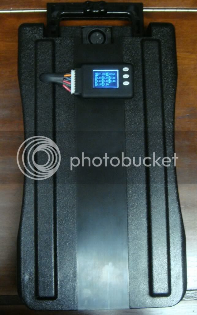

UPDATE: Well, I've finally found some extra time on my hands (read recoup time from minor operation) to finish up an idea or two I had. I think the finished product will work very well for what I have in mind.
The way that I've been carrying my two 24v battery packs on 'The Falcon' has been one on each side of the rear of the bike, in hard panniers. While I liked the look of the panniers, in real life, they are just a bit bulky for me to use for everyday commuting. So, since I used the rear rack off an Ezip bike for this build, I thought that it would be nice to be able to use the original Currie Battery Pack case, and put Headways into it.
After much trial and error, I have finally got the result I'm looking for. Now I can slide the packs into the rear rack, nice and neat.
I'll use a CellLog 8s on each pack to monitor cell levels, and to use as a Low Voltage Alarm if needed. I'll set the max amps out with my CA. And as I said, it
is still the stock form factor, and will slide into the rear rack just as originally designed.
When it comes time to charge, I'll use the original port to charge with, which is hidden under the handle when it's folded down and on the bike. I will do the cell level balancing as needed (read at least once a week, probably twice) using the balancing lead you see that comes out the front of the case. I just unplug the CellLog 8s, and plug in my bank of 8 VoltPhreaks. I have made a custom harness which will also have the correct balancing plug that comes off the charger circuit so that I can monitor with the CellLog 8s as the pack charges.
So, now all that is left, when I recover from this surgery, is to remove the hard sided panniers with the Ping style packs in them, and replace them with a modded case on each side of the bike.
For 85% of the time, the two 24v10ah cases, run in series for 48v10ah will be more than enough to get to work and back. For those times when I want to travel more, I will be making two additional cases to use to increase range. When the first set of two get low, I simply remove from the rack, and replace with the two backup cases, which will be in my trailer.
So, for now, that will be my new power system on The Falcon. If a cell goes bad, I can replace it much, much easier than on a Ping style pack. Less weight, less bulk, and will probably end up looking better on the bike. When I get better I'll actually install on The Falcon, and post the updated photos in the build thread.
Anyone out there riding Ezips interested in a mod like this?

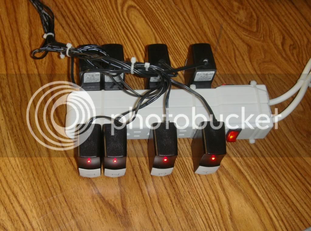

So, even tho I'm using 8 VoltPhreak LifePo4 single cell chargers, going thru the 8s balance plug, are you saying that this method is not advisable? It is my understanding that the VoltPhreaks do exactly that, charge up to aprox 3.6 and then taper the current down to 0 for the remainder of the charge cycle.
So, do I understand you to mean I should have done that with the VoltPhreaks before I assembled the cells in series?
Using your single cell chargers with your power strip array for a series connected pack accomplishes the same thing as parallel charging them all at once. It's like having your cake and eat it too. :wink:
The only reason I charged them indivually when series connected was for the sake of leanring what i could about it... I only have one charger :roll: . No point for me to do again that way, as I have learned what i wanted from the excercise.
Frankly, now that all of my packs are pre-balanced (some the tedious manual way and some by bulk parallel charge), I either just bulk charge them, or use the hobby charger to balance charge them once in a while. Your set up will perfectly balance charge them every time. :mrgreen: Your golden. 8)
We want only guys on happy journies :mrgreen: right?
Suggestion: when you set up your single cell chargers in their array, I would make darn certain that your negative and postive wires are spliced together correctly before plugging them in. The voltphreaks chargers are not reverse polarity protected :evil:

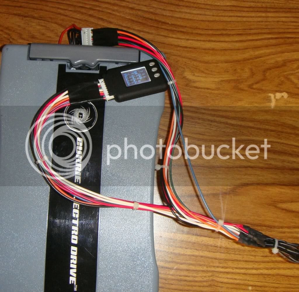

I am very much looking forward to the day when somebody comes up with a rugged BMS design that more closely emulates those single cell charger arrays. I think Goodrum was working on one, but I lost track of that thread... so much of the discussion was so far over my head :roll:
I know of only one charger that can actually charge at about 2 to 3 amps directly through the balance leads (FMA is the brand), but I am not sure if they also use a bleeding resistor setup like most BMSs and balancing hobby chargers, or not. If so, I wouldn't see any advantage to it. Oh well... lots more research and waiting to do I suppose :|
It would be nice to get a charger like that, at a reasonable price. Here are a couple of shots of my homebrew array. Nothing special, except maybe where I ran two balancing plugs in parallel so that I can charge and keep track of values with the CellLog 8s. It works great as on OV alarm too! :)
Notice this pack being charged is my V1 model, with the balance leads exiting from the back of the case. Not the best spot to do that with, but this will be an extra pack, so no biggie on this one. I also like that I can record with the CellLog as I charge, to see the different profiles of each cell during the charge cycle.
TJG
