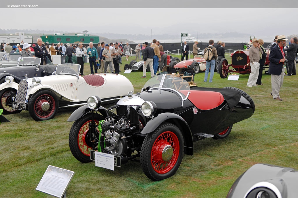

Or borrow a vintage Morgan look...
cycle cars often have simple curves and three wheels...
