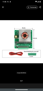

Aha works like a balancer right? Just connect it manually or something right?
It's a active balancer! The battery BMS main function is to prevent over discharge and under discharge it has very limited balance function.I have cheap Chinese batteries and they go out of balance when abused.

This balancer is separate from the BMS.You connect the wires to the series same as BMS b- b1 b2 ect.You can buy extra connecters for other batteries/packs.View attachment 362054View attachment 362053

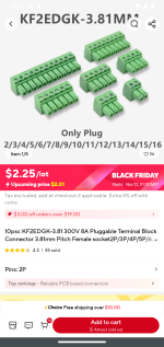

Hmm I found connectors that look like the ones in your image here: https://www.aliexpress.com/item/1005007029621946.html?spm=a2g0o.productlist.main.1.612f5df0YZXAaS&algo_pvid=e72b293a-dfd8-4302-aa9e-f2f59ee3c80e&algo_exp_id=e72b293a-dfd8-4302-aa9e-f2f59ee3c80e-0&pdp_npi=4@dis!EUR!1.34!1.34!!!10.00!10.00!@2103868a17321776047197848eca34!12000039151204596!sea!NO!167266123!X&curPageLogUid=ShKuywneBgqc&utparam-url=scene:search|query_from:
But I did not find that specific machine/equaliser you have in the picture. Do you have a link to that one or what is that called? If I understand you correctly you have soldered/created an interface between the connector pin of an incompatible connector pin, from a BMS, to those connectors above at the other end that makes it possible to hook it up to your equaliser through that cable/interface? thanks
