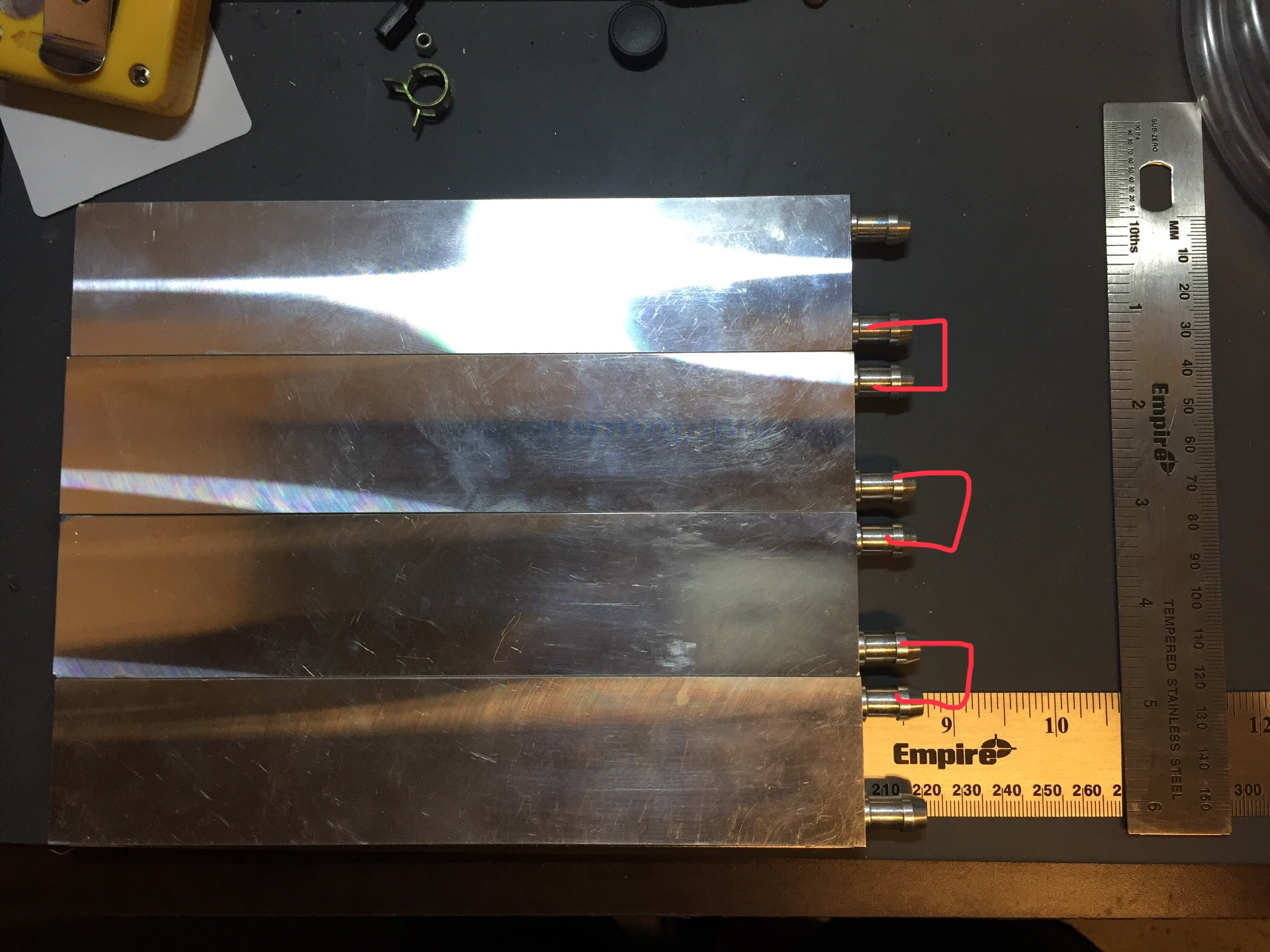

I’m trying to develop An active liquid cooling solution for my electric kart build which runs on a 44ah 13s lipo pack. It’s gets pretty warm during extended heavy use (heavy acceleration and hard pulls).
So far I have a custom water block put together using multiple small water blocks lined up together. I’m stuck trying to figure out the best way to connect all of them in series. The problem is the barb of the adjacent block are so close to each other that simply connecting tubing together will cause a kink in the lines. The connections made need to be flat in the same plane as the cooling plate in order to properly fit under the battery pack (the small ruler on the right side shows the confines of the space this water block plus tubing connections need to fit in):

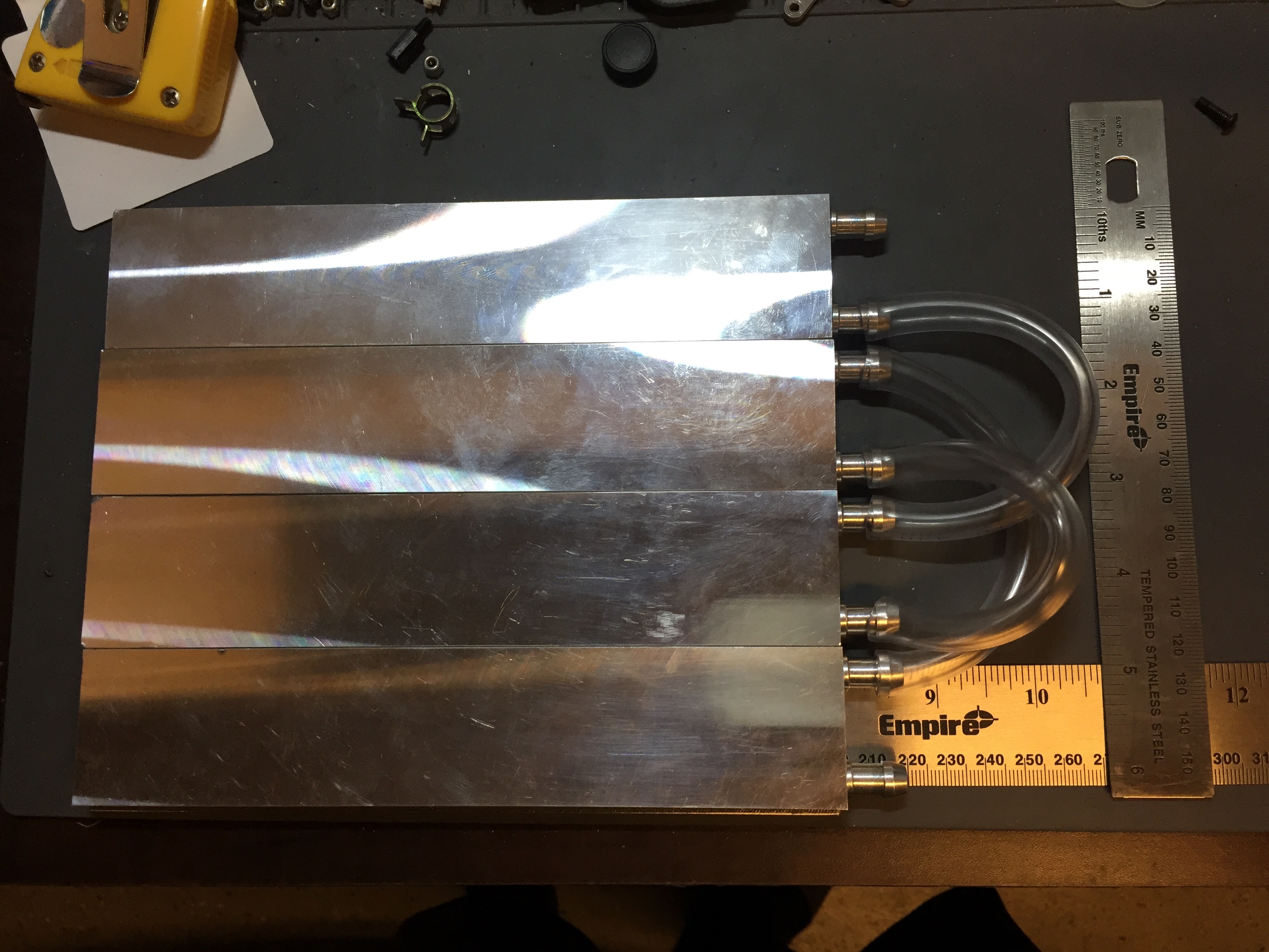

therefore I can’t do a alternating connection method to alleviate the kinking issue as such because the overlap of the tubing will kink on top of each other once the battery pack sits on top of them:
What would be a way to connect two barb fittings that are this close to each other?

get some vinyl tubing and a metal coil spring that'll fit inside. dip in boiling water and form the bend you want. let cool in cold water. voila permanent bend no kink
So I just use the tubing I have now and fit a bending spring inside and follows the steps you mentioned?
LeftieBiker said:
Copper U fittings.
How would I secure the copper pipe to the barb fittings?
Depending on what they are made from, you may be able to carefully stretch the copper over them and use sealant, or do the same and solder them. I'm assuming that the fittings aren't plastic.
Do you want to connect adjacent nipples like the red lines, or non-adjacent like the clear tubing picture? Either way, find a cooperative auto parts person and look for an existing molded rubber hose that will work as-is or cut to suit. Hose clamps to taste, spring-type probably better than worm drive. Hose manufacturer Gates has online catalogs you can browse.
I am assuming that you are using 6 mm tubing & fittings ?
Are those nipples in the heat sinks screww in ?
Look for “John Guest” tubing and fittings ... plastic , push fit PVC flex tubing system used for leak proof pressure plumbing.
