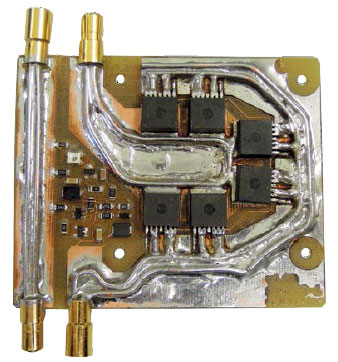

I ran across this, and see the circuit and explanation is available on Circuit Cellar.
X-Treme Inrush Current Limiter
Good to 40V. The layout is interesting.
