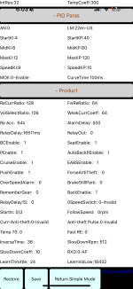

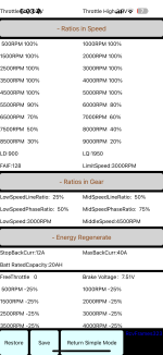

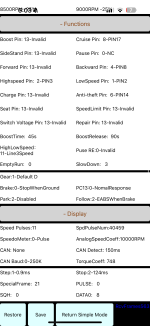

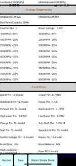

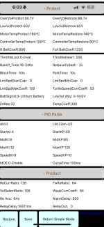

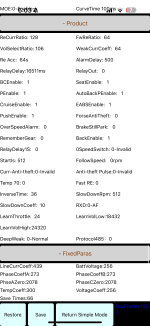

I have a 2023 Admitjet armor with fardriver and currently running the tune in the pics. I have 17in supermotos and ride almost exclusively street. I’m new to tuning but watched a lot of videos so this is what I gathered to do so far. My goal is top speed and currently running 14t front and 30t rear sprockets. Any and all advice is appreciated

You can try to raise the ratios in speed in the upper range.
Which max rpm do you reach and what is the line current when max rpm is reached?
What speed? (how fast?)
What are your battery specifications? Voltage, current limit, etc?
The faster you go the more power it takes to do that; if hte battery can't supply it, or can't without stress or damage, then it's inadvisable or impossible.
