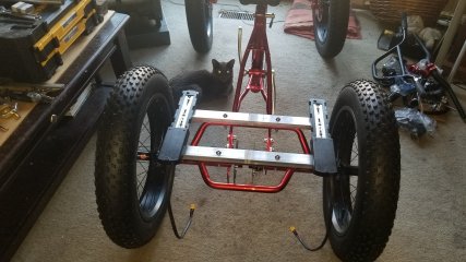

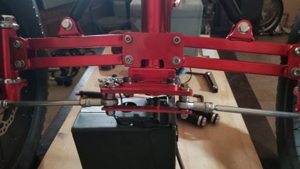

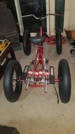

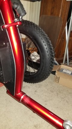

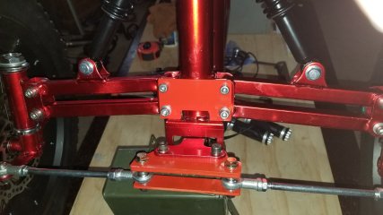

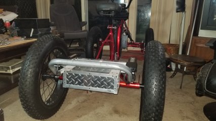

First order of business, was to assemble, and reinforce the front end. The steering tie-rods were not even/parallel to the upper/lower arms, and as mentioned in above post, too short. I made an additional 'extension bracket', with the tie-rod mounting holes about a 1/2" wider from centre, side to side. Allows for use of original tie-rods with usable adjustment, again. This also allowed me to drop the tie rods down, to get them parallel to the upper/lower arms with stiffening reinforcement with additional bottom bracket joining the two tie-rods at the bottom of the bearing surface.
In addition to this, i fabricated up a reinforcing gusset plate for the front of the upper/lower arms. Sam Pilgrim's bike broke the welds joining the brackets to the front of the frame, with the abuse that he threw at it.. i don't plan to do similar abuse, but better safe than sorry.
I've got full hydraulic brake replacements coming in for it - including a dual brake front brake setup. I'll be using 180's i've got kicking around, to upgrade the as-provided 160's for the front brakes.

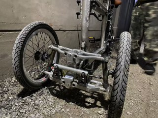

我想做点四轮的胖胎车正在调研

我想做点四轮的胖胎车正在调研
Interesting photos.

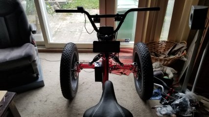

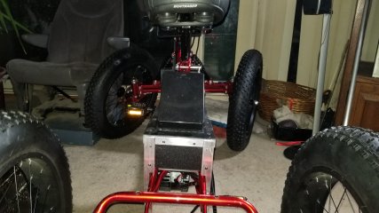

I'm encountering questionable design issues with the front end of mine - i'm sure it'll be on the list of major rework items, in the future. It's a budget quad to base a project upon, after all.
Just to make mine workable to my satisfaction in the interim, i'm revising the steering methodology right off the bat. It doesn't really work as it is set up now. Not safely, anyway.
I have my work cut out for further reinforcement of the axle ends and steering tab on the front end, and i'm detecting something suspect in terms of slop and flex with it, as it is. Ideally, i need to revise the suspension arm mounts to one at least being an actual a-arm, as well as spread the arms out for more effective suspension. May involve patterning up new components to take to the welder, that can be bolted onto the existing suspension frame mounts as new sub-assemblies.

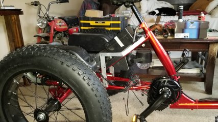

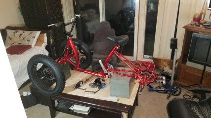

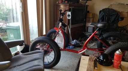

It got put on it's tires this week, in the middle of the living room. No longer sitting as a lump of components on the 'build table'.
Assembled, it's bigger than i thought. I might have problems in the garage.

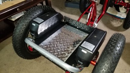

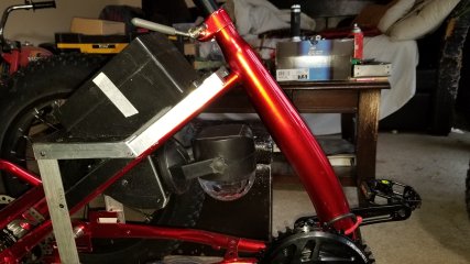

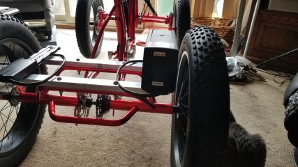

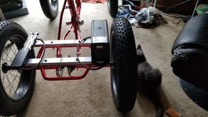

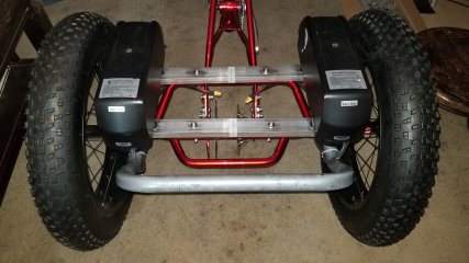

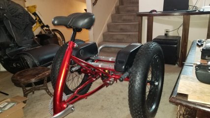

Just fooling around with mounting methodology for my twin battery packs, using components recycled from a previous project. That's on this coming weeks' to-do list.
Battery subframe complete. The cat, approves.
If anyone is wondering.. no, it doesn't fit going through the patio door. It'll require the wheels coming off for that to happen, as such it'll only be a partial assembly 'in house', before i take outside to the garage to install the BBSHD and other more heavy bits and pieces.

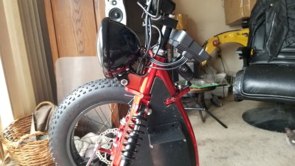

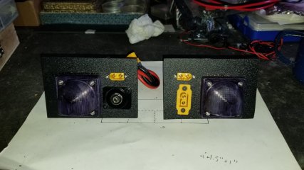

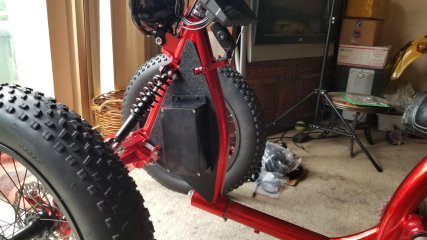

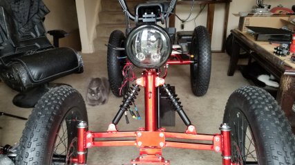

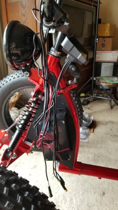

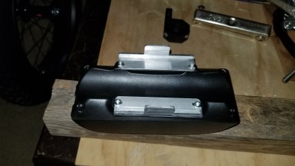

Switched gears, so to speak - working on the front end electrics setup. Part of that is paneling in the frame portion behind the steering tube, to build in a reasonably sized integral electrical junction box, where i can place the wiring connections for lighting wiring connections, horn, down-voltage converter, bus bar, and fuse box, enclosed by winged project cases on either side of the panels. This essentially makes that a hidden frame space, to feed any excessive wiring into, as well. The black sharpie rectangle, indicates the rough location footprint of those. winged project cases. They'll act as a joined compartment.
Photo shows the template that i am working with for initial material cutting. Material being used is 3/16" HDPE Board. They've already been cut out, and i'm finishing the final shaping, while i wait for the winged project cases to arrive in order to do further cutting and mounting of them to the panels on the forward bike frame.
My inspiration for this, is what is done with old school Honda Passports and the like, and using frame space to hide electrical components, battery box, wiring etc out of sight and mind, behind 'side-covers'. that the winged project cases will serve as.
It'll be functional, in form and appearance. It isn't going to win any styling awards.
I've also fabricated and mounted a bottom mount perch onto the steering tube, for the motorcycle headlight shell. I've got a 5.75" low/high beam led headlight unit to be mounted there. Now that I see it in a photo, i have a bit of an urge to work it further with a 'speed holed' pattern on the drill press. It's a plain old chunk of aluminium without sense of style, just sort of hanging out there at present. Same goes with the battery rack, but that's a WIP.. it's all a WIP, subject to evolution/revision on the fly.

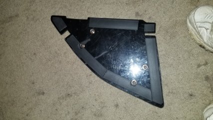

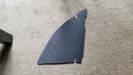

I shortened up the headlight perch, bringing the headlight bucket much closer to the steerer tube. Headlight shell assembly is a 5.75" LED unit.

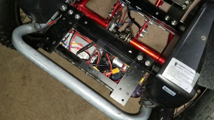

I think the logic of using concealed side-covers and adapted project cases to deal with excessive wiring, is plenty evident here. I've got lots of additional wiring to deal with, in addition to the BBSHD motor kit wiring runs Part of that is running more than a few toys.
The secondary large screen that can be seen in the photo is a cheap Android auto/Apple carplay unit that i picked up to play with. It's got rear view camera features, bluetooth music streaming, as well as GPS/Mapping features through Google.. but does add to the wiring involved, as will also the additional switchgear on the handlebars/crossbar.
With wiring out of the way, the 'project box' solution looks pretty clean. Still playing with positioning - it's secured in place at the moment with some double sided sticky tape.

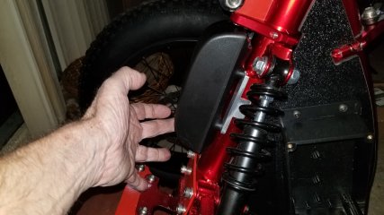

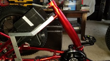

I brought in one of the battery packs to test fit. I might have built it out too close to the wheel. If i can get the locking key in and out, i'm good. If not, i'm going to need to cut back by about 1" (or, just slide the rim assembly off the spindle to make a bit of room to fit in the key..). The basic structure, is good however. Another wiring junction box needs to be located on the seat tube risers, for the battery cabling, and dual battery balancer module. An appropriate one is inbound, expected in a few days.

A little update, a week later. I've lined the side-panels with 1/4"x1" high density 3m rubber gasket material to make for a relatively tight seal with the bike frame. I don't think i need anything more than a couple of strategically placed jumbo zip ties, to tie the two sides onto the bike via the frame tubes themselves, very securely.

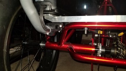

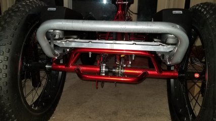

In my parts pile the past week, a component caught my eye - something i was intending to use for another project idea that died a stillborn death. Anything for an excuse to yank off a component, and give it some further work and modifications/refinement to make up something multi-function useful.
Part of a bicycle carrier for a car - i'd scavenged road-side at one point.
In my mind's eye, it serves the perfect role of rear bumper guard, protecting the rear of the batteries from direct impact from a roll back into a tree-trunk (for example) as well as defining the end point of a small platform, with a raised retention edge. Also a great place to do a 'safe lift' of the quad-cycle, if need be, integrated into the overall quad-cycle structure. It't secured in place with 4 roll-bar light bar 32mm clamps, dowelled in and attached to the existing frame mounted cross-beam bars for the battery mounts.
This is screaming for me to attempt a bit of carpentry with a few nice Oak slats, to make it a proper beach cruiser, in overall style.

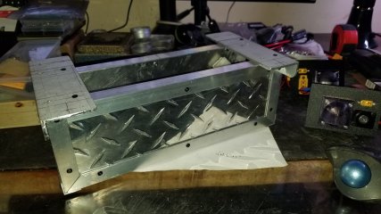

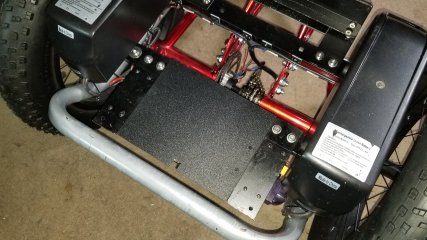

I had ordered another couple project boxes - but they didn't really fit the bill in terms of what i wanted in terms of durability or ideal size dimensions. My first intent was to encase the 52v-12v power inverter, the 2 battery balancer module, and all associative wiring, as well as serving as the electrical connection panels for the motor power/controller output, dual battery inputs, and charging port for the dual batteries. I believe in airflow to keep the electronics cool, so i wanted a case that acted as a 'tunnel' for volumetric active flow-through, with dual 40mm case fans acting in push-pull configuration, with part externally shielded intake / exhaust ports.
I have to do one more small electrical panel connection, for main 12v input/output. Ran out of room, on the two end panels.
The case will then be fit to the rear of the battery rack subframe. It'll all be decked over with a removable cover, and largely weather tight with application of silicone sealant.
Measures approximately 12.5"x4.5"x4". It's been a fairly intensive 2 weeks of working on this aspect of the project, so far. I'm fairly chuffed that it actually came out nice and straight.

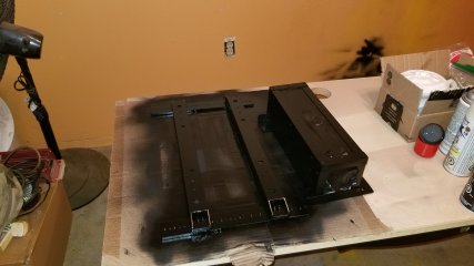

On to paint stage for two sub-parts of the rack assembly. It's fortunate that i've got a spare bedroom 'workroom' that was pre-trashed by a previous teen larvae of the previous owner, that i can go to town in, with a window open, with the weather changing decidedly cooler the past few days.
I'll give it a few days to set before i flip, i laid on a thick yet run-free coat, miraculously. No rush, but this will allow me to part final reassemble the final combo rack assembly and start in on the wiring.

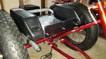

The overall rear deck/battery mount assembly is nearing to completion at this stage.. about 90% there, with rear tail/brake lights incoming to complete.
I'm not real happy with 'neatness' of my first wiring attempt, so will likely rip out some of what i put in today, but no biggie.. it's just apparently some more needed soldering iron practice and some more shrink tubing involved. I was attempting to retain some electrical disconnects - but i should have just clipped those out, and proceeded with all new wiring. The wiring bundle got pretty lumpy, as a result. Better to consign these LED pods to permanently mounted and wired-in use - clipping them out and replace accordingly, if they do happen to fail. Lesson learned, and about 1/2 day wasted, if i choose to redo.

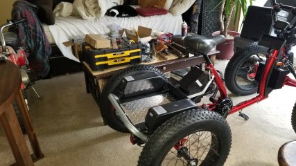

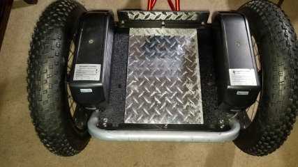

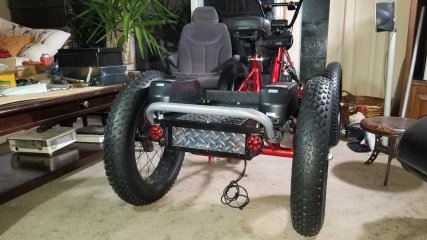

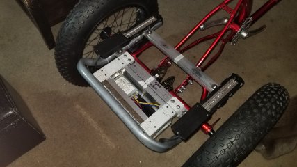

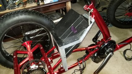

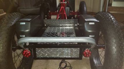

Almost done on the rear rack/battery bracketry assembly.
Above shows electrical component box, tied into the main battery rack frame. The PVC top slides back and free for removal, within the side channels, secured in place by two easily accessible bolts, allowing free access to everything underneath. The top is self-locking in place, in front channel.
Electrical component box is dust protected by its own separate cover. I was inspired to use the last of my 16ga checker-plate as a applique on the PVC top for both appearance, and grippage for items on the platform, that may be under a cargo net or bungee restraint.
Found the PERFECT rear lights for this - 2" round LED units, attached to the platform top. Remove the wiring quick disconnects, and they come with the tray, as a unit. Tight integration into the overall assembly.
A couple of more views of the overall assembly. This is built better than a Cybertruck! :LOL:
Electrical components in electrical component box is now fully wired up and functional, feeding off the dual battery balancer module. The project now lives with a fetal heart-beat. Moving onto wiring harness.

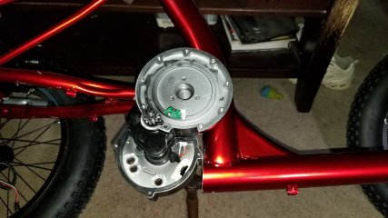

Well, Feck.

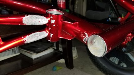

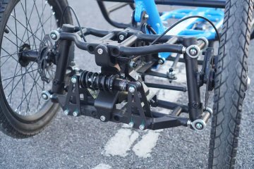

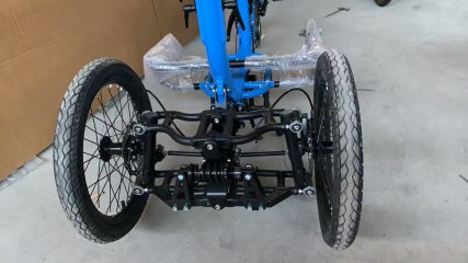

I wish i had looked at this photograph a little closer. This bike i had seen on Aliexpress, for sale around $2000.00 with the motor kit. It was clearly a single example - and no wonder. Looking at the photo, the chain stay has been bent/pounded seriously DOWN to clear the motor. It's clearly taking a quarter circle around the motor to accommodate, whereas the frame is horizontal when unmolested. Sam Pilgrim's solution while still compromising in my opinion, is the frame mod with less impact on overall frame integrity.
With the blue bike and the motor above the chain-stay, that chain-stay pounded/warped like it is - it can't be good for longevity, and my prediction is that it will likely fail catastrophically.
I'm not happy with either solution. I'll need to look at Sam Pilgrim's solution in detail, and decide how to proceed.
I had to disassemble the BBSHD into it's four major components, so that's apart now, so that i can work with the weight of just the core casting, that has the interference points on it. If i can get the frame minimally modified, and reassemble the motor around it, i might get away with that.
This was after i just dealt with a cross-threaded bearing cup in the bottom bracket, with some precise hacksaw surgery.
Just posting it here right now, in case anyone following with a similar project.
I haven't even pulled the motor out of the shipping case yet (sitting where it was deposited in front hallway 2 months ago)... but, ahaha.. visual proof, that what i thought would work with the BBSHD, will. Sam Pilgrim didn't really eyeball his motor all that well, and cut and bashed his frame to fit with in the 'correct' down position. That won't do.
The correct way to do it.
After a week of eyeballing it, agonizing over it, saying 'i don't wanna!!' countless times - i broke down today, committed to the 'Sam Pilgrim' fitment mod to the chainstay and end frame tube closest to the bottom bracket. It took several hours to use my great grandaddy's handed down 'no screwing around' jumbo beat-down ball-peen hammer to progressively shape the bottom of the chainstay to clear the bafang motor without splitting the tubing in the process. Success.
I didn't want to do it, but it is done. That hammer probably hasn't seen that much use, in 40 years, since grand dad passed.
Breaking down the BBSHD to it's core, made it so much lighter/easier, to fit-test, so that i could see just how close i was getting to the perfect fit. I got it close enough, without having introduced any slop, when the motor is dropped into the bottom bracket - it locks in place with no movement, as is. In retrospect, i didn't need to trim the end cap of the frame tube as much as i did.. but i trimmed less metal, than Sam Pilgrim did. A big step forwards. It wasn't as bad as i feared.
In the off chance that anyone would do this mod again with this quad and bbshd - break the motor down to the core, then beat the underside of the chainstay progressively into contoured shape to clear that portion of the motor, and then determine how much to remove the end cap and smooth the weld of the frame tube, to clear the front of the motor. I subtly re-contoured the fastener extrusion of the core case, for it to slide smoothly without friction to clear, once the frame tubing was reduced by hacksaw and contour filed first. Patience and a fine eye, is key.
Or, just buy a CYC Gen 2 instead. Apparently that goes in without any frame surgery, or beat down with a hammer.
I'll touch up the paint with hand-brushed Acrylic to protect the bare metal, and then assemble the motor in place.

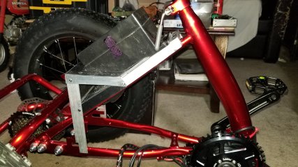

A Further Foray into Free Form Fabrication!
(see what i did there?)
While i love the overall results with the rear battery carrier/mini-truck style platform over the rear axle, i felt that it terminated abruptly forward of the platform leaving the seat stays as wasted space on the frame, and i needed additional real estate to mount and/or hide additional modular 'Glow Rider event' options onto the bike, remove when not needed, as well as locate an intermediary wiring junction box for that purpose, built in. It'll match what i've done per the frame covers on the front sides of the bike.
Went into it with a rough idea and rough dimensions of what i wanted, and have been building it using some eyeball-aided Imagineering. It looks industrial, i'll be the first to say that about it - that seems to be my overall aesthetic with this thing, as a project. Function first. It'll be rubber mounted/separated/gapped from the battery carrier/platform as a separated assembly.
Fabricated primarily of .75" x 1/16" angle, and PVC plastic sheet of 1/4" and 1/16" thickness. This is at about the midway point of what i intend as the 'final product' Doesn't look like much with 10 days working on it, but there are quite a few hours into it now. It's hard to build up something 3-dimensional straight and true, especially when fabrication tooling is relatively rudimentary.
