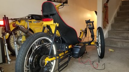

Basically, i am tricking this out, involving a 1000w Black Magic Pie 5 Vector 20" rear wheel/hub assembly. The tires got replaced by a 2.4 Schwalbe Moto-X 20"x2.4 on the rear, and Schwalbe Big Ben+ at 20"x2.15. This is going to be a rail-trail special requiring a bit of range, so dual 48v19.2ah battery packs are in order. I will also be running a full 12v lighting/electrical system, using a 48v -> 12v voltage down converter buck, off the unused battery at the time.

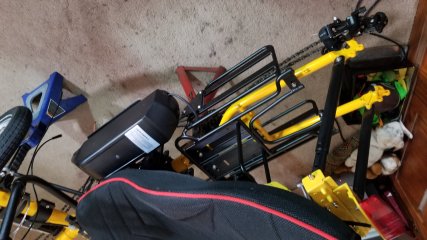

As shown in photo, will be the intended fit of the twin battery packs on either side. It will require some significant fabrication work on my part to make it happen.
It's all ok.. i already further refined my fabrication skills with replacing the frame suspended fabric seat original (meh) with a Hard Shell seat pan, that came as a Pan only. Mounts totally up to end user. Ok, i accepted that Challenge.
Fabrication by hack-saw blade, files, hand drill, and time.. lots of time. I am a bit practiced at this sort of shade-tree craftsman low-tech fabrication technique..
At time of writing (March 21st, 2021) i have a bunch of parts that have come in to install, the battery carriage structure to build up, a gear cluster to rework for optimal reduced chain line spacing rear gear ratio (building my own cluster, out of 3 of identical construction but differing gear teeth ratios), changing out all controls, putting 203mm 'big brakes' on the front end.. basically a month or so worth of work, remaining. I'll post up additional major updates as they come.

I ended up grabbing an 8" hunk of aluminum rectangular 6"s4" - 5/16" box section, and started carving away at it with my tried and true shade-tree fabrication methodology of hacksaw, files, hand-drills, and introducing into the mix, a drill press with various hole-saws.
I got it (mostly) finished and sprayed, just needing two sets of two small brackets to tie into the rear rack and adjustable track slider, and it's good to go.

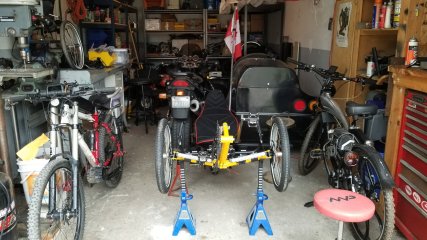

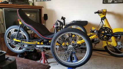

As such, I got it off the coffee table to check seat reach, and put it on jack stands to start actually putting things together again.

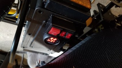

I finished off the core electrical/junction box last night. I have been waiting on several small, but critical to finish parts and pieces to come in yet, in order to put the driveline back together and get the controls set up, so i went back to the electrical enclosure/48v to 12v down voltage converter Buck/circuit box.
Keep in mind, part of this function of this project is using up some of the materials left over from ~30 years of hobbies or activities that have occupied my time.. so little money was spent on this (at this time), relatively speaking... just time, and creativity.
This is the core portion of the electrics on my Tadpole.. All functions are switchable, with a master switch for master power disconnection. No battery contact sparking with disconnection/connection of the battery lead.
Photos show the existing functions, so far.
In the remote situation of having to do a quick inspect on the rear end or pump a tire up in the dark, or whatever, i've got a couple of rear facing white Chip LCD modules.
On the top of the electrical box, i had a Cigarette Lighter 3-1 function gadget that i converted - shows voltage output, and case temperature, as well as a USB charge port. I've got three computer fans in this, pulling air in from one side, passing it over the down-voltage buck converter, and dumping it out the other side. Switches are Master Power, and Fan/rear facing white Chip LED's.
I've got a red LED strip wrapping around the box, and an illuminated amber reflector on either side, also. Both will be switchable from the front.. Red LED strip will also be tied into a red LED whip/visibility flag, to be added yet. I still have to wire out to the front lights, and the rear running light.

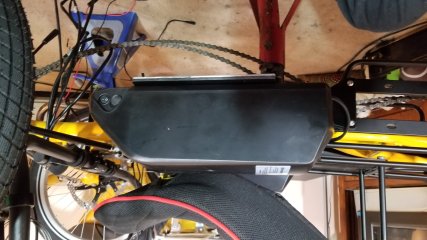

A cautionary tail about these shark/hailong pack cables, sometimes they can burn out if not given proper corner relief. The corner relief provided by the "shrink wrap" (I use quotes here because it doesn't actually shrink upon testing) is minimal.
I'd open up the mount and add some extra shrink wrap and/or braided sleeve to help prevent shorts from forming over time. The one that came with the BBS02 kit that I built for a friend had a 1" long shorted/burned out section of the battery cable that I believe did so by wearing through the stock covering around a corner on the bike frame or similar.

A good observation, and you are entirely correct. The length of cabling is both inadequate to allow a strain/movement loop, as well as there is a risk of internal wear from sharp corners.
I will open them both up, and add/replace additional length of wiring in the next day or so, cover and route accordingly. :thumb:
Sounds good. Also of note is the cables they use are the high strand count "soft" wire... not sure of the technical terminology. It's more flexible, but in my opinion less durable. I'm not going to recommend a strand count or anything, just suggest you look at what kind would suit your application best.
Strand quality/count was acceptable, so i just spliced in and soldered a 5" additional section of equivalent gauge wire, shrink-wrapped the splices, and used some braided cable cover to replace, and good to go again. Certainly more acceptable, now!

After a full weeks of wiring OCD... I've got it fully operational. I am going to call this going in Freddie Mercury Mode... because it is going to be garish and Flamboyant as Hell in appearance. Four external circuits control whip and strip lights, rear and side marker lights, front DRL lights, with the fourth circuit available for additional LED spotlights.
Switch panel includes an LED clock/cigarette lighter/USB port charging module.
I will be the first to say that this is over the top in terms of overcomplicating things... I'm a sucker for a good project. I do still kind of hate wiring tho.. especially wiring harnesses.. making one for a freaking Trike, is certainly a new one..
LED whip, additional spotlights removable (not shown in pictures/really not sure if I need them to be quite honest.. but wiring provision is there).. I can run as dark or as lit as I desire. I've actually got an motorcycle horn to wire in yet also... The wiring harness has the leads roughed in already.

Also, free picture post. Upon getting up this morning, I decided to liberate the project from the living room, so that I can wrap up final assembly in the garage.
