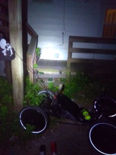

Im glad to hear things are going mostly well and learning. Ive found a lot of learning from your posts. The data is great also. Any chance you know the weight or dimensions of the base vehicle?
Figures are approximate,
-Current mass: 41 kg
-Wheelbase: 1170 mm
-Front Track: 980 mm
-Rear Track: 660 mm
It's light, maneuverable, grippy, and it hauls ass. Given that it's Juneteenth, I have the day off work and I was out looking for a street takeover to join, but no dice. I badly want to see how it compares in a 0-30 mph sprint to the local Surrons and Talarias riding around illegally!
Two weeks ago, I did go riding it in a storm drain tunnel. I was looking for homeless camps to give people food and maybe share liquor with, but only found a moldy couch with a bunch of used needles around it. My camera's battery died before I could get pics of the couch.

I didn't choose the dimensions. I bought a KMX framekit from Utah Trikes in 2016 and built it that same year. It started life as an unmotorized trike with intent to build an electric velomobile off of it. The first upgrade was Adam Roy's front suspension kit. I first built it into an unmotorized velomobile in 2017, and had it converted into an EV with an upgraded body shell by 2020. This was my first ever e-bike build and it reliably did 45-50 mph top speed depending upon battery state of charge, weather conditions, tire selection, ect. with a meagre 46.8V battery pack, Leafbike 1500W 4T motor, and Phaserunner controller. That second body got rear-ended by a truck while I was stopped at a red light and the body gave itself up to save me from injury, and went back to an unshelled trike, but motorized and upgraded to 72V and a 3T wind of the same motor, ASI BAC4000 controller, rear suspension kit from Adam Roy, and was able to reach 71 mph on 10 kW. This year, I converted it into a quad using a Dreambike tricycle conversion kit and All-Axle front hub motors from Grin with the "Superfast" 3T wind, and two Phaserunners(they get hot very quickly, too).
This frame has over 90,000 miles on it. I have another KMX in the box unassembled. I was going to use that new frame to build the quad until I realized I didn't have space to store two recumbent trikes plus a Milan SL.
This is a very stoutly-built frame, and the weakest part about the KMX is the steering spindles. Damn shame KMX are no longer available in the USA.

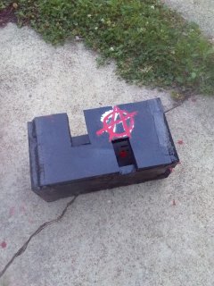

Yes. In my case, I'm not sure that they would do much good because I'm using my trike's frame as a heat sink. The Phaserunners aren't made for the sort of power I'm pushing through them. A single full acceleration run to top speed will make them go from cool to hot before I even top out. I do have two of them in my possession that I will try at some point.
The Phaserunners are also a temporary measure. I'm going to upgrade to XT150 connectors on my front hub motors and use a controller that can do 150A phase current for each at some point in the future. I don't know if I'm going to do this before or after adding a middrive to power the rear wheels.
This thing will eventually get much faster. I'm aiming to be able to accelerate like a Surron Storm Bee. Not even close at the moment.
I raced a Lincoln MKZ tonight and held my own with it. 70 mph to 0 mph in a panic to make a red light without going through it was doable without the brakes overheating. 30-70 mph acceleration is about 6 seconds. Holy crap this thing is SCARY and it's not even half as powerful as the one I just bought. I hope I don't kill myself with either.
