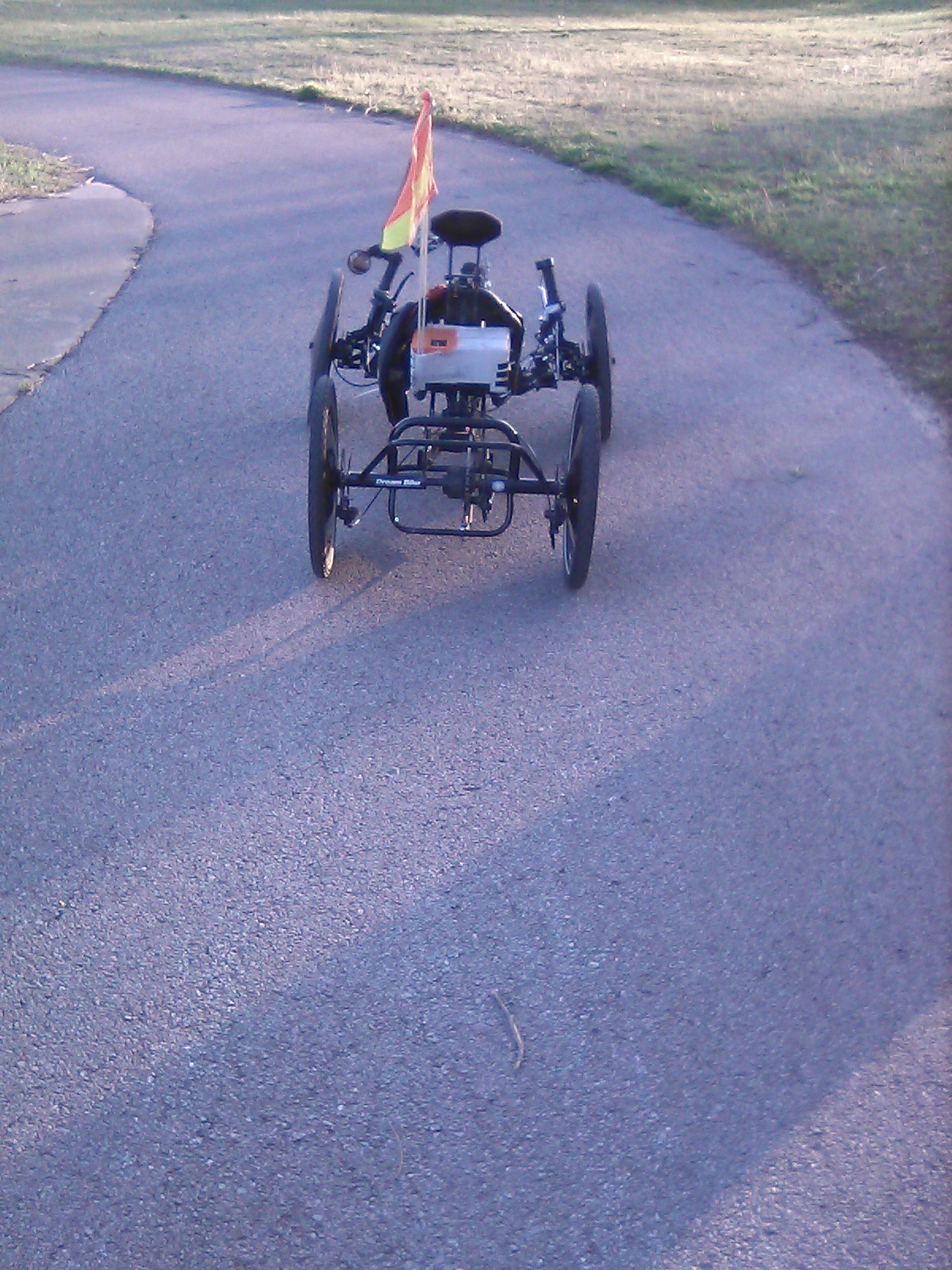

Ballpark 160 on the rear - best add some meat (or replace) to those 15mm rear axles - especially if they've not been heat treated. Schwinn Meridian's are/were famous for losing a wheel.
Just a thought, the Sun USX delta has 20mm axles w/decent 36h aluminum disc hubs & disc mounts. I occasionally spot one on CL and eBay.
I had tabs tac-welded to the differential housing, but they posed a clearance issue to the frame. I need to remove the sections marked in green, then see how it fits up. Once everything fits flush, I can drill holes to fit M6 bolts and mount the differential housing to the brake caliper mounts on the KMX frame. Once everything fits with certainty, it will be time to do the permanent welds and then repaint.

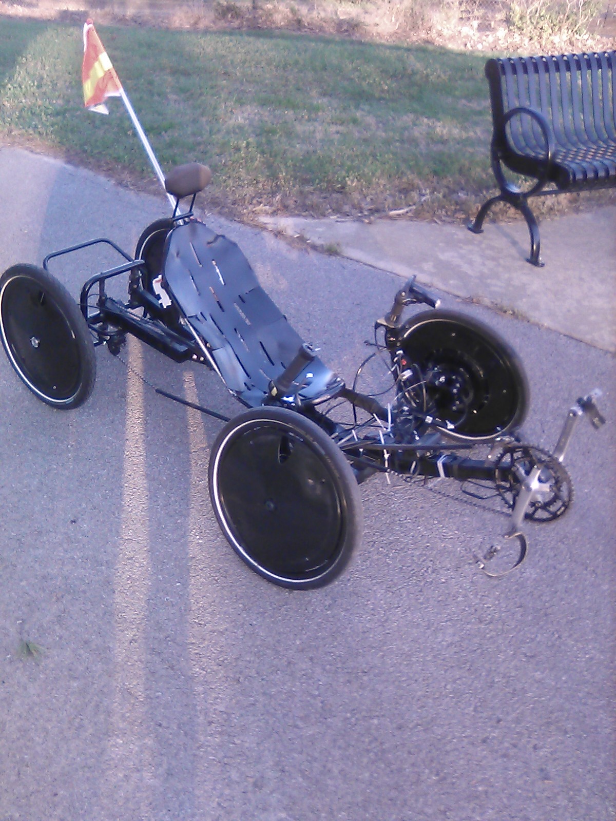

Hoping to have it going this weekend as FWD electrically, RWD pedaling, and AWD using both. With twin Phaserunners, it won't accelerate as quickly as the previous 10 kW rear hubmotor setup, but it might do 90 mph top speed without a body on it, but I don't think I'm going to be testing that anytime soon.
Update. The front motors are now concealed by aero disc covers. On the outside cover, you can't tell there's a motor there. On the inside cover, you can if you look closely, but the body shell is going to cover that once installed. The differential housing has been modified to bolt up to the brake mounting holes on the KMX frame while the bottom of the housing fits flush to the frame itself, to eventually be secured with steel zip ties in an 'X' pattern. So there will be three M6 bolts securing the housing to the brake/flag mounts of the KMX frame(two on the left, one on the right), two square-shaped dropout bolts securing the housing to the dropouts of the frame, and steel zip ties on the bottom. That thing won't be moving. Aero disc covers are now on all four wheels as well. Maybe a test ride tomorrow.
Got it working, but it's not yet reliable. Hoping to finish work on the rear end this week, and get it painted. Currently running it at 1500W. I'm hoping we get snow at some point before the spring but after the vehicle is usable as a daily so I can test the AWD.

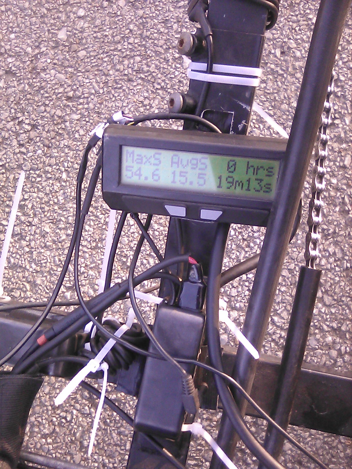

I was hooning around and went for a ride on the nature trail. I reached almost 55 mph. It had a lot more to go, but losing traction with the front wheels and accelerating like a car to 55 mph on a "bicycle" was enough retardation for the day. I bet I can hit 85 mph in it as is without a body. Mid drive not yet installed.

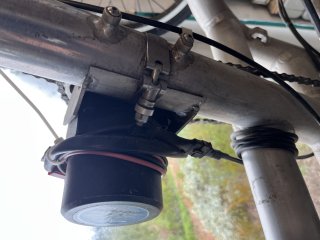

Molicel P42A pack inside of a plastic housing formerly used for another battery, encased in a corrugated plastic box zip-tied and C-clipped underneath the rear of the seat. XT150 connectors to the battery, with adapters made to the 45A Andersons on the Phaserunners.

Without a body, I measured ~650W to cruise 35 mph on flat ground. That is a lot better than I expected. As a single-motor trike with no body, it would have used about 800W, and as a single-motored velomobile tadpole with my previous shell design on it, about 400W at the same speed. 55 mph used about 6 kW.

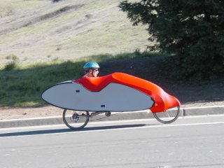

I did recline the seat a lot more, enabled by the quad layout and installation of rear suspension, so the frontal area is closer to that my my Milan SL velomobile than it was as a custom designed tadpole velomobile. I had a frontal area reduction of at least 20%.

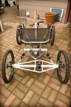

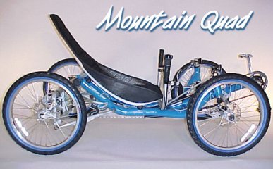

What make/model of Quad is that in your picture?
Mountain Quad.
Originally designed by Jon Nichols, he sub-contract frame building to me when, without warning, he walked away leaving tooling and construction supplies behind.
Picking up the mantle . . . I changed a few things and made a couple dozen more.
There is one left in the shop with a motor installed between the cranks and front axle.
It hasn't been used in 7 + years.
Basically "New, Old Stock" condition.

Is it full suspension? I can see rear shocks.
Front shock(s) are the Cannondale Headshock where the modest travel movement was contained in the fork stem.
In automotive parlance this application would be called "sliding kingpin".
Mountain Quad was marketed as offroad.
