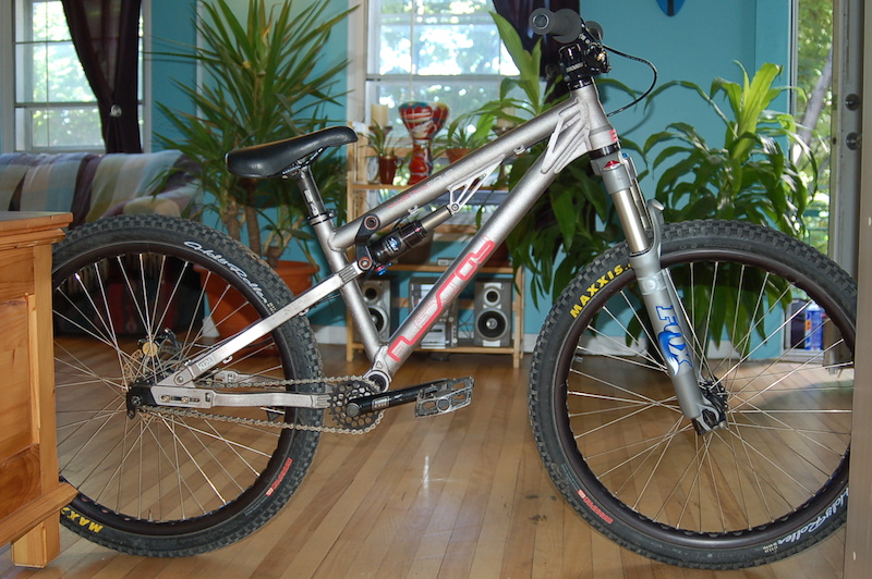

26" at front would most probably make the angle of the bike very awkward to go up hills. But amazing going down them!
I would most probably have to covert to only having the smallest front chainring to avoid more possible strike. And have to consider just getting rid of the rear derallier and just put the smallest teeth ring at back - no point in going to more granny than the small at front anyway for hills.
or should I just sell the 4065 - retitle this thread and get a 12t mac already laced...?

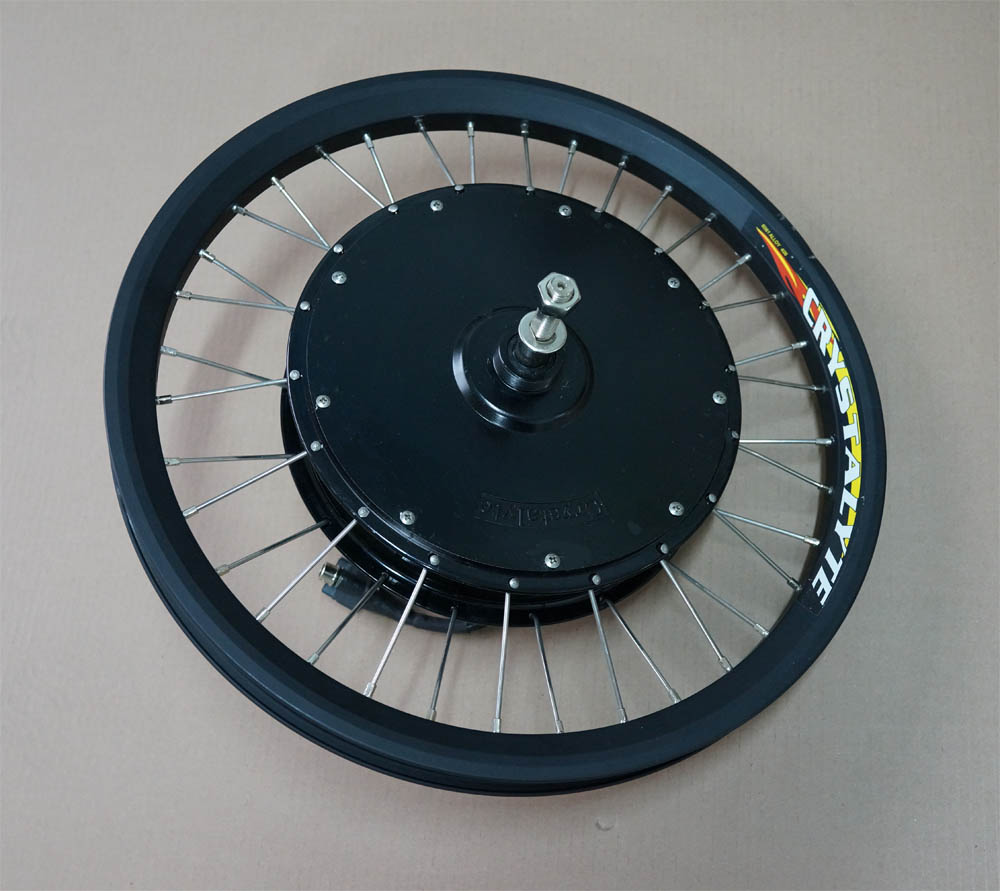

One of newbs wheel builds a few years back looks pretty awesome and gives me an idea about the pain in the ass the radial will be.

I dont have the $3k yet to go aft.. I want to try 20" drilled hub as the final attempt - if that disappoints too much still then I have some strong experiences to share. eg. even a 20" fat 4065 at 2800 watts cant compare with the aft in granny gear for climbing...
I also am building a wheel and have one Alex rims DX32 but could not source another for reasonable price. I have 17" moto rim which i decided to use with x5303. Have you thought about it? Check this one out:
http://www.ebay.com/itm/PRO-WHEEL-M...Parts_Accessories&hash=item43c600079a&vxp=mtr
Might be good alternative. There are dimples that are angled for cross lacing. You will end up larger, 22-23" depending on the tire put i think its a good alternative.

agniusm thanks Newb also gave me lots of info on the moto rims - I was looking more at 14" sizes to get as small as possible. Problem is then I am not sure how the advantage of angled spoke holes will actually work when so small a rim and on such a big hub. I will stick to radial, it will be a pain to drill out the holes in the dx32 and hopefully with lots of hard work it will fit in. 19" rim with 2.5" tyre should be close to 20" anyway.
I've got a ton of customizing to do.
I need to source tubes, spokes, spoke puller? thing that cuts and threads them too, taper for cranks other bike tools .... list goes on.

Actually instead of bmx I reckon building onto one of these with out a seat would be shit hot. would just make an aluminium piped skeleton to hold a an abs box, stick some sort of seat on it. tons of battery room.
just as a gauge of what my wheel will look like, this 4065 is in a 20" I think.

avoide radial lace if you can, it will be ok for a few months but the life span is so short becuaes spoke are being pulled very hard because there is no tngental angle to transfer torque.
19" bmx/trials rim the pedals will hit the ground with out leaning!!
honestly go for 17" mc or something. equal 22+ out side diameter (how bicycles are mesured)
