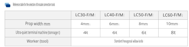

I've been looking around for proper waterproof connectors to use in place of the XT60 I have on my battery and motor controller and found the LF series from Amass. They seem to be a waterproof version of their LC series connectors. They come in 3 sizes: LFB30, LFB40, and LFB50, at least for the 2-pin (B) versions. Some notable features include:
  • IP67 rating
  • Crimped wire connection
  • Locking connector
  • 3 sizes to fit wire from 14AWG to 8AWG
  • Rated at 65A with 55°C temperature rise on largest connector with 8AWG (if anything like XT series then they can probably handle much higher current)
As far as I can tell, using the various datasheets as well as Amass' FAQ page (last item on page 2), you're supposed to use hexagonal crimps with "width" (auto translated) from 4mm to 8mm, but I'm not 100% sure what that means. I emailed Amass and a distributor to ask so hopefully I'll hear back from one of them soon. Note that both the LC and LF series use the same pin/sockets.
LC/LF series crimp size table
Has anyone looked into/used these connectors before? I've been looking at some other options but so far these seem like the best option. I found them for sale on a few different aliexpress sellers, as well as on TME. Once I figure out exactly what crimp tool I need I think I'll give them a try.

I'm not sure if those are supposed to be used with ferrules specifically. I've found some hydraulic crimpers that are for wire lugs which seem like the correct tool based on the FAQ page. I'm still waiting on replies to my email though.

I heard back from TME and they said:
The product team stated:
There are no dedicated tools for the AMASS manufacturer. Most customers use tools to crimp pipe joints. (ring tube terminal)
So it seems like those wire lug crimpers I mentioned previously would work, or basically anything designed to crimp this type of connector:
I'm gonna go ahead and order a tool and some LFB40s (from aliexpress, TME doesn't seem to carry the LFB40) and see how it goes.
