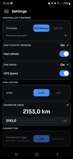

The application supports two firmware variants, switchable in Settings: factory OEM Bafang firmware, and bbs-fw, the open firmware developed by Daniel Nilsson. Both are handled by the same app and the same cable - switching firmware on the controller only requires selecting the matching mode in the app, nothing else changes on the phone side.

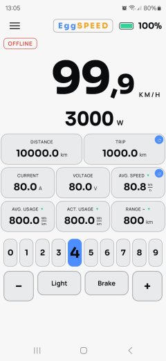

  • Live dashboard replacing the factory display (speed, battery level, power, brake status)
  • Full read and write access to controller configuration, including while riding

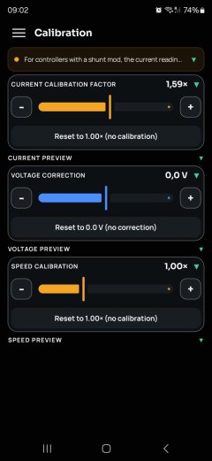

  • Current and voltage calibration for controllers with a shunt mod or a known pack voltage offset

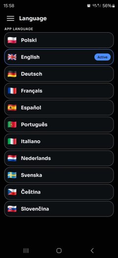

  • Language support expanded from 2 to 11 (German, French, Spanish, Portuguese, Italian, Dutch, Swedish, Czech, Slovak added), including the bbs-fw configuration screens

  • Speed calibration multiplier, same approach as the existing current calibration, with an optional GPS speed comparison on the dashboard

Quick bump - been shipping a bunch of updates to EggSPEED lately, including a big translation pass (11 languages now: PL, EN, DE, FR, ES, PT, IT, NL, SV, CS, SK). If your language isn't in there, tell me and I'll add it.
