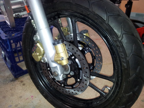

Today I got my new front disc brakes from Metalgear up in Queensland. They take the mounts from mine and attach new rotors. They look good and make me feel a lot better about the braking setup.

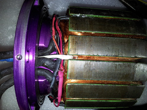

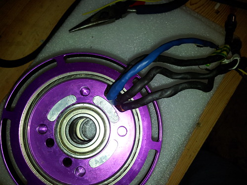

I have also fitted a temp sensor into the motor that will work with the Kelly controller. Originally this prototype had a cheap thermistor that was wired incorrectly. The new sensor is amongst the coils and should detect the temperature very accurately. I have also recovered the wired coming out of the motor for all the sensor wires.
New Temp Sensor by Splinter, on Flickr
So far for this motor I have repositioned all the Hall sensors, replaced the temp sensor, rerun the sensor wires, and changed all the bearings. I will be re-assembling it for the last time over the next week (work permitting) and it will be mounted in the bike never to be removed again (unless I get a production version soon).

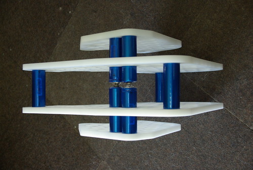

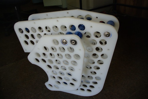

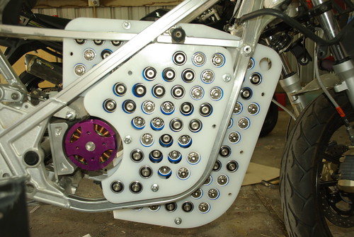

Ok after weeks of work and jury duty getting in the way I have finally got to the next step....
The battery mounting plates have arrived and I will be constructing the pack over the weekend.
Just to show how this will mount up I took some photos today...
Battery Mounts by Splinter, on Flickr
That should give you an idea on how the pack goes together and how it will mount up.

OK I was wrong about the material. Luke first talked to the material suppliers about it and they were talking Acetyl. What they settled on however is Polyethylene (High-density polyethylene I believe). I will get the invoice from the guys next week and confirm. They were supplied the weight of the cells and the number of mounting points and this was the recommendation.
All four plates weight 3.6kg each plate is 15mm thick.
As much as they sag, are heavy and low energy density, Headways sure are easy to put together. Looking good mate!

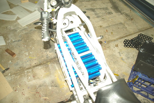

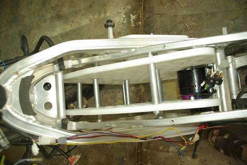

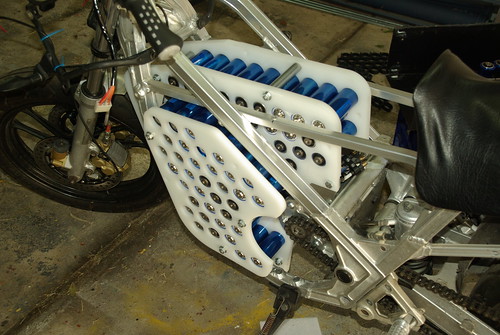

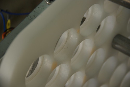

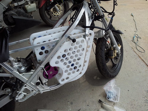

Ok so I have the bike home with some threaded rod, bolt and spacers to work out the layout of all the components on the bike.
Here is a shot of the way the plates have been machined to hold the batteries in place.
Battery Mount Size Layout by Splinter, on Flickr
Note the spacers so all the pressure is not on the batteries themselves.
See they will mount straight through.
Setup with all batteries in place so I can calculate and drawup the electrical connections.
Bike still feels light easy to move and lift of the stand etc....
Tony, she looks awesome! Very neat job :)
You still have room for an on-board charger under the tank? (Which I still haven't sent you the mould for :x after Christmas OK?)
Or is that where the controller goes? Either way, it looks very professional.
Current plan has the BMS and Controller under the tank... 12v system behind the battery pack.. Charger somewhere if I can fit it.. otherwise off board.
That is the main reason it is home so I can layout all of the other components. Pieces of the jigsaw are fitting together.

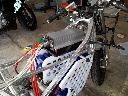

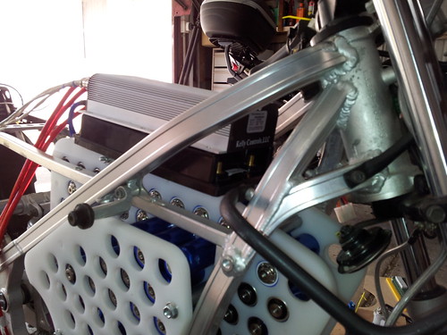

Now I have the bike and the battery pack back home I am working on how I will fit all the components into the system.
Here is a shot showing the BMS, contactors and fuse. They will all fit nicely on top of the centre battery plates.
BMS and controller layout by Splinter, on Flickr
Now I have replaced the BMS etc with a plastic box of about the same size to see if the controller fits... and yep it looks good.
The tank (hollowed out) will fit well over all that. I plan to put all the 12v gear in the gap above the rear shock absorber.
Any comments? Do you think it will work that way?
