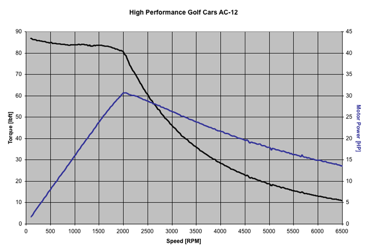

Ok see if I get this right... the heat in the motor is due to the current level. Hence we needed to find the max continuous current the motor could take without overheating. Based on our tests that is not far under 270amps without the water cooling. We have not been measuring the load... however with an electric motor you know the kt if you know the kv... (http://www.ezonemag.com/pages/faq/a405.shtml -- kt = 9.57 / kv Metric--) hence we know the torque produced by the motor.
This motor has a Kv of 75... therefore a Kt of 9.57/75 = 0.127
At 270amps that means 34Nm.
Now the Kt(and Kv) stays constant right up to the efficiency point of the motor....
Like this...
Note this is not this motor but a 3 phase brushless inrunner..
Now power is linear function of torque and RPM...
Power [kW] = Torque [Nm] x Speed [1/min] / 9549
All we need to know is the efficiency point where the back EMF due to high RPM's stops the increase. Let's guess that at 5000rpm
power = 33Nm x 5000 / 9549
power = 17.27Kw
If 6000rpm is the point then...
power = 33Nm x 6000 / 9549
power = 20.7Kw
Hence the 21 Kw we think this motor is capable of.

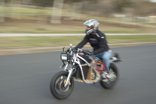

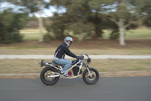

Ok so today I put the motor back on the bike... put the controller on, set to 50% motor amps (250 amp max), and took my life into my own hands.
Here is the photo record, video soon.
First Ride0 by Splinter, on Flickr
First Ride1 by Splinter, on Flickr
First Ride2 by Splinter, on Flickr
Now during the rides the BMS was cutting out the battery due to high amps (it is set to ~50amps). After a few runs I changed the kelly to only pull 20% battery amps and that stopped that. Tomorrow I will up that value until I find the highest value that does not shutdown the BMS.
I will also wire up the throttle and some switches to replace the control box.
Video up now...
[youtube]28W7udn2Nzg[/youtube]
Your battery pack looks rather close to the front wheel - is it just a bodge-up until a better arrangement comes along?
Looking forward to the video :D
Nice! :D I love the sound of it! What's the max RPM again? Sounds like it would wind out quite nicely :D
Congratulations on the test ride. Bike is looking great. But sounds friggin' awesome. :twisted:
