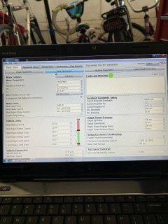

I have a Bac2000 that came out of a cub cadet electric mower. There are two. One runs the drivetrain. One turns the blade for mowing.
I have successfully connected to one of them with the Bacdoor software. However, I am unable to get it to work. I had to connect the throttle to the controller via pin 7 as the Pinout shows. It was originally handled through the cub cadet ecu via canbus.
In the Bacdoor software, I can see what my throttle voltages are at both ends. Around .8v -2.5v from low to high. I can adjust the parameters so this should be 0-100% throttle. It shows as if the throttle is working on the software, but I can’t get any movement of the motor.
I found a couple of posts on here that had .xml files for different motors. I have attempted to load them and get them to make the motor move, but to no avail. I am confident the motor works.
Can anyone lead me in a direction on which parameters may be preventing the motor from spinning? I know the brakes could be preventing it, but I have adjusted them to different levels, but still nothing.
I would really appreciate any help! I can provide any information that is needed including the original .xml file, specs, anything just ask!
