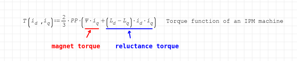

The torque equation
8891251592493930539.f562ce66152952915e4ec36107372565
From the torque equation you can draw a few conclusions:
  • iq=0 will always produce zero torque
  • id doesn't produce any torque if (Ld-Lq) is zero (an outrunner motor for example)
  • There is an optimum id,iq setpoint that maximizes the torque

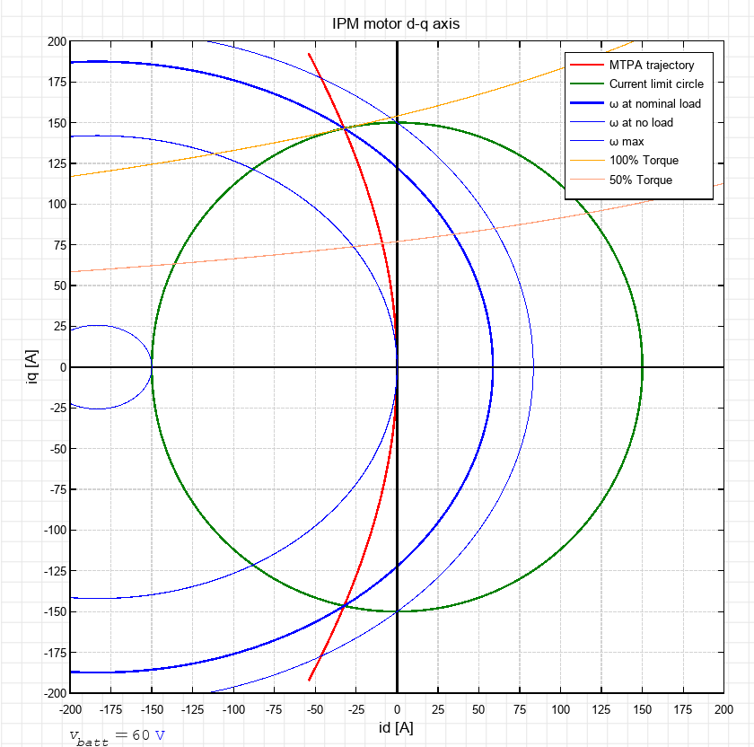

The end result is something like this that shows each torque component.
8339281592491394578.f9919da6af975d8ae5c63f5d8ffa22f6
Because id,iq are 90° apart from each other, if id=0, the resulting vector angle is 0°, meaning no reluctance torque is produced. When we start adding id the reluctance torque increases, and the total produced torque becomes the sum of both traces.
By far the best thing we got out of this is understanding better the motor control theory. We developed math and reproduced equations and tools to produce a d-q axis plot of any IPM machine.
This is for example a customer's IPM motor for a custom-made extreme density motor controller we made for them.
7387911592494368523.3da17487bcf46c780d9d190da3f2a898
On a quick glance you can see at once:
  • the ideal MTPA trajectory (red)
  • how salient the machine is (how tilted the red trajectory is)
  • the current limit you are operating on (green)
  • the voltage/speed limit ellipses (blue)
  • the torque profile of the machine (orange)
  • and once you understand it you can easily see the exact id,iq currents needed to operate at any allowed speed/current target.
We also found the limitations of conventional Field Weakening algorithms and why they need to be improved if we want a linear throttle response on an IPM motor.

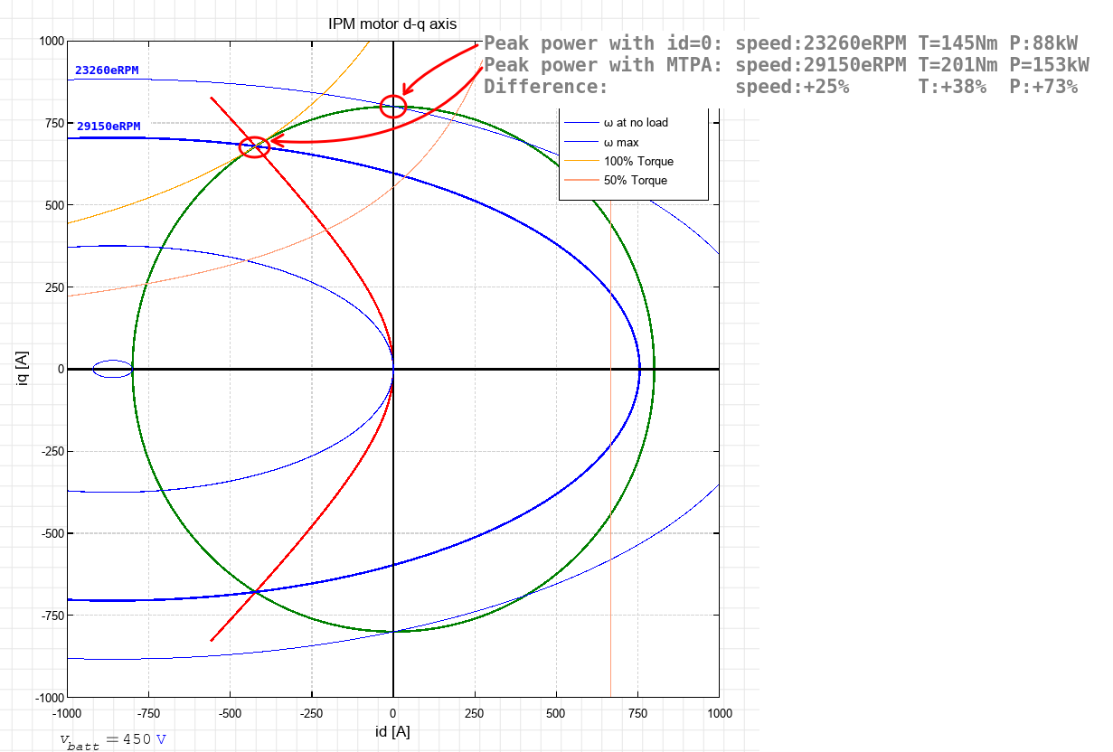

MTPA is not only about increasing torque. The addition of id current also increases the full load base speed of the machine in the same way Field Weakening does. So you have more torque, more speed, and hence, more power!
In the Nissan Leaf motor, the improvement is huge. You can see the peak power operating point shifting from the right circle to the left towards a smaller (higher speed) ellipse while intersecting a higher torque torque curve.
589331592501387528.12f0ec7ae18bd27b5abfed0bee947806
That's right, this algorithm provides:
25% extra speed
38% extra torque
73% extra power

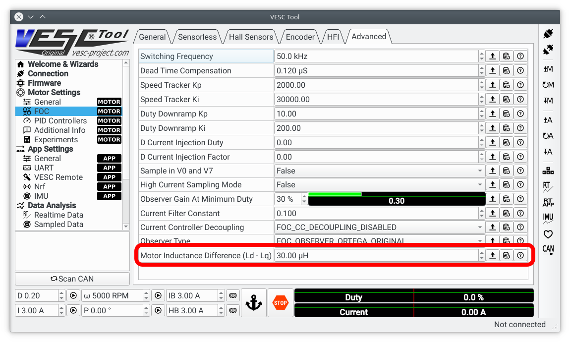

So the firmware will take the current reference is and separate it into the optimized id,iq components.
We added to the GUI the single parameter that controls the MTPA algorithm:
5191551592493972223.25acc32bdbb8e6d224f089363ecd375b
The Ld-Lq parameter can be measured from the vesc command line or by manually searching the peak torque on a dyno.
Besides that there were a couple of errors in both VESC firmware and in Texas Instruments app notes that had to be fixed in order for MTPA to work.

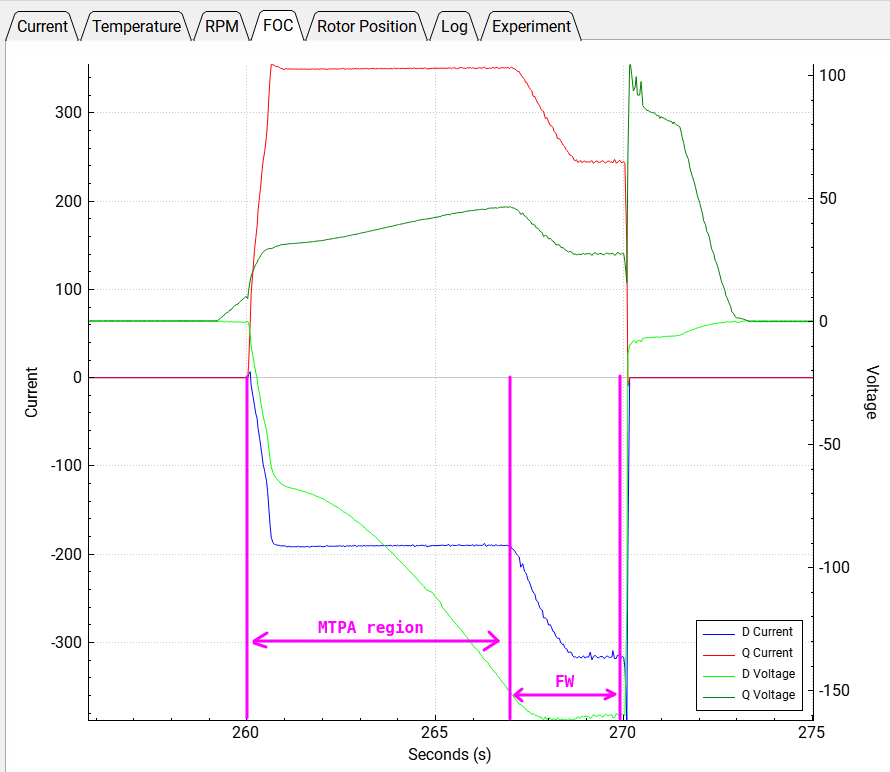

The pull request comes after long testing sessions. Let's see the algorithm in action:
3442751592493987058.e6c6a6987ffae5b9f6f2f8d5ba5e5879
In this real time plot you care about Q current (red) and D current (blue). A simpler FOC controller would keep D current at zero, but we can see how D current increases to increase the net torque in the MTPA region.

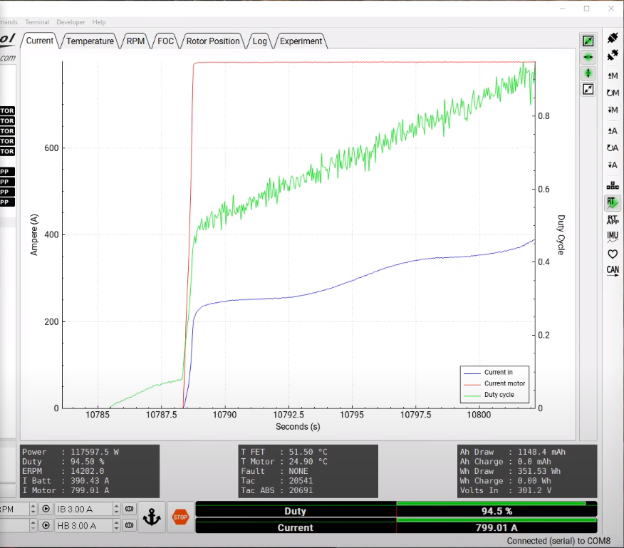

That's a light testing at 400 phase Amps, but we are regularly testing all our firmware improvements at 800A and have well exceeded the 100kW target even at lower than rated battery voltage.
A typical 800A dyno run looks like this:
5410311592494004747.59f05181f51b590b58cef8280c260d0a
And a sneak peak at a dyno run, with the motor under test on the right side:
