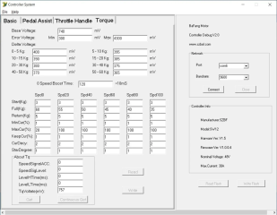

You want control, and X1 flashed controller (and the cracked software files) has everything - clear up to 300NM Torque output.
Such setting vary with a User's tastes.

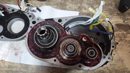

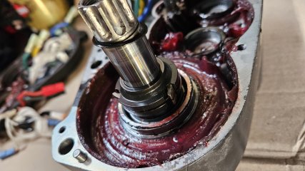

2019 model
I do about 5,000km a year, so this is approx. 25,000km motor. I ride in rain or shine.
I will replace my clutch next service. I have had no issues with my motor.
This is factory grease

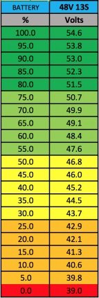

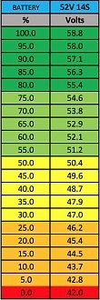

No, no, no. It's not you, and in fact you have an excellent battery management program.
Recharging at 20% is a safe 'V' that won't brick the battery - and yes it happens. You run to, say 15% and one cell (common) is very slightly lower 'V' than the other 55 cells, but the effects are magnified by depleted batteries and if forces the BMS to constantly (off/ on. off/on. off/on) try and balance, Which expends current, causing more 'V' degradation.
If you put the bike away w/o recharging), it will bring 'V' down to a point below the BMS allows - which bricks you battery as a DANGEROUS fire hazard - determines it's 'V' is UNSAFE.
Other side of the coin is charging to 80-85%. From 20 - 85% provides superior life-span and performance.
The key is dumping % and using Voltage Readings.
Here's some 48 and 53V charts to get a full sense of it.
I'd be cool with such programming as you describe. Forces me to be idiot-proof, and that's really hard.
This does not mean your batteries will last. It only means they'll get the best chance to.
A brutal skeptic, I doubted the '80 x 20% charge' concept and researched the seminal sources. All were using 18650's and produced results in various degrees from 30% - 40% longer total mileage lifespan of the cells.
