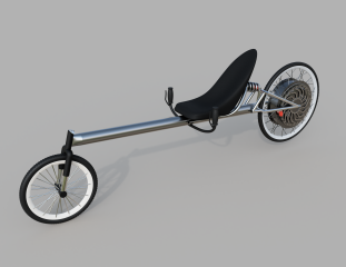

I have decided to build a new ebike.
Currently i drive a viola mart 1500w rear hub kit and its served me for almost 4 years now.
Parts ive bought so far:
Qs 3kw 50h hub motor
Jk smart BMS 8-24s
Lot of 18650 cells (qty 260)

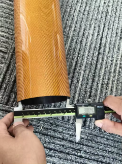

4in round carbon fiber tube for the main frame piece.
Rockshox air shock for rear
Planning to buy a 250a 85v spintend Ubox VESC
4in wide copper strip and nickle plated steel

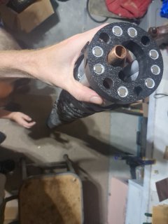

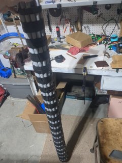

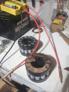

Right now im working on the battery.
I have access to a cnc and lots of scrap HDPE plastic so I cut cell holders out of that. Will cut matching copper donuts to spot weld. The pack will be 20s12p and stacked up like donuts in the carbon tube. A wrapped copper pipe runs through the center of the donuts and so will the balancing wires. (See pics)
Plan for the rear wheel is to use custom hdpe tube clamps on the carbon as to not put any holes in the carbon, and that will create a hinge for the stainless tubing wheel carriage.
Im not really settled on a plan for the front, like what wheel size, under seat or over seat steering ect.
Another note is i am planning on a full lighting system but no details on that yet.
Im open to discussion on any of this since its my first custom build and there is a lot of knowledgable people here!

I'm guessing here, but your mock-up picture shows no pedals.
Your profile suggests you are in Ohio. No pedals means no ebike - legally it can't be a bicycle or be ridden under bicycle laws without pedals - it is a motorcycle.
Perhaps your mock-up is incomplete?
The mock up is incomplete, but it would be a motorcyle due to speed anyway.

Couple problems with this idea..
On a recumbent bike, pedaling can extend the range massively.
It's also important to have a place for the feet to rest.
Without pedals, and a very large motor ( easily capable of highway speeds on this setup ), you are building something very obviously not legal at a time where laws are tightening and actually getting enforced at times.
You will not be able to legally argue it's a motorcycle unless you somehow get a VIN and register it.
Another big problem is the QS hub motor weight will make the rear suspension basically useless. That QS is the heaviest hub motor ( ~30lbs ) in it's power class.
Due to the weight balance of this bike, and the small rear wheel, you really need a rear suspension.
This will work against your goal of running high speed.

Your selected motor is ~30lbs and the problem is that this is a massive amount of unsprung weight.
You also have a 20 inch wheel and that's a disadvantage over bumps in itself.
I'd consider a way lighter, maybe even chain driven motor... or at the very least, maximizing the size of the rear wheel to counter compensate for the enormous reduction in suspension ability.

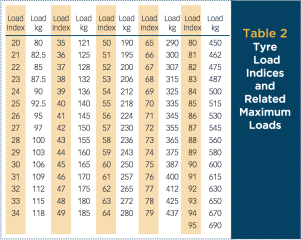

If the goal is a proper street legal motorcycle > DOT < approved tires are required.
(Department Of Transportation)
Weight and speed are the basis of the rating.
Bicycle tires have no such requirement.

Oh, also, about the carbon fiber backbone to your design.
I did my development of all three vehicles in my signature with Quantum Bicycles in Perth, so I spent many hours (over several years) in his shop watching his work and talking with him. He can do just about anything (he's a Raleigh frame builder) and he's the go-to guy for carbon frame bicycle repairs in Perth, so I've seen a lot of frame failures in his shop.
Carbon fiber splinters when it breaks - I've seen a lot of it. Look at where your crotch is in your current depictions. The price of failure is rather high, perhaps?

Seat suspension would be more for ride comfort-ability.
I see what you are saying, the only thing suspending the motor and rim from impacts is the tire and air between them and the road.
Im interested in making it 50 mph capable and planned on front and rear suspension to keep the tires on the road as much as possible, I guess that wasnt clear.
I feel like you maybe oversimplified motor power, doesnt hub diameter and stator width and stuff like that have a large impact on torque?
As for the carbon fiber, what causes the failures?
What one does to increase power also may have effects on other outcomes - size, weight, torque, etc.
'power' is explicitly defined as a rate of energy delivery - that is, how much energy is delivered in a defined amount of time. Power is a rate. Power is not energy. Infinite power for 0 duration does no work - no energy is passed.
For a wheeled vehicle traveling through a resistive environment (friction from road, resistance from air, bearing friction, etc.) the maximum rate of energy delivery (power) will eventually be balanced by the resistance, and this leads to a top speed - where the opposing inputs balance. That's why there is a top speed - even when suspending the wheel in the air 'without a load'.
In ideal space, absent matter and other resistances, the smallest power input will lead to acceleration approaching the speed of light (infinite energy is required to attain the speed of light, so I write "approaching"). Yeah, it will take a long time, but there's nothing that will stop it happening.
On the road, you'll reach a speed limit. And it's more power that will be needed to exceed that limit (or less resistance - I can lose some fat to streamline me).
A larger motor can pass more power. As we can't pack twice the matter into the same space, that often means a motor with a greater diameter. This also means longer lever arms, and so that motor may produce more torque. But it doesn't produce more torque because it can pass more energy per time unit - power. It produces more torque because the diameter is greater.
As for a wider stator, this is quite identically putting two of the original motors side by side on the same axle, so yes total power as well as total torque will increase. This does not change the distinction between power and torque.
This is a coincidence, rather than an equivalence. Power != torque.
Load exceeds strength of material and geometry.
Keep in mind that this is a leverage problem. Time * acceleration = energy accumulated. Time * deceleration = energy dissipated.
This means you accelerated to your speed and thus your assembly (vehicle + you) is now carrying a certain quantity of energy. When something more substantial imposes itself (tree, car) all that energy will be dissipated somehow as you decelerate to a stop. In the case of a tree or a car, the distance and the time that energy is dissipated over is probably quite a bit less than the distance/time required to reach that original top speed.
The ratio shows up as a multiplier of the forces involved. On your body, and on the frame members of your trike.
I remember a 'Dennis the Menace' cartoon from long ago with Dennis standing on the sink in the bathroom about to jump off onto a bathroom scale below with the caption "Watch me weigh a 100 pounds!"
Two feet of acceleration divided by 1 inch of deceleration is a 24x multiplier. The scale will probably break, as may your trike frame under those loads
The only other factor to consider is that an automobile driver will decide if you crash. You can't avoid that. You can mitigate it. No, it didn't happen today. That has no bearing on it happening. It will happen, so design for it.
Carbon fiber (meaning carbon fiber in a resin matrix) is NOT STRONGER than steel, alumin(i)um, titanium, wood. It is only stronger per weight and then only in some dimensions. You can always achieve the same strength with other materials (aside from water, I suppose) by arranging them differently or using more. Carbon fiber is not used to achieve strength - it used to achieve strength for less weight.
And it brings along the problem that when you do exceed it's strength, it splinters into spears that shred your body parts.
If you want strength, design for the strength you want. I would not use carbon fiber without extensive experience and enough engineering training to be comfortable doing the stress calculations (which I went to school for). It's not a magic material.
