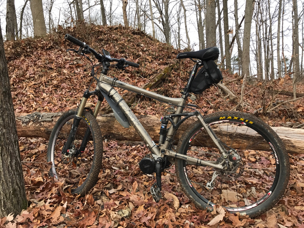

The kona King Kikapu looks like it might be a contender, has anyone had any problems with it before I try ?
I decided the only way to find out was to order it (the Luna Eclipse 42T), and to my extreme pleasure, it fits my 2009 Fuji Thrill LT 2.0 perfectly with no spacers required!

Giant xtc Napa 16 inch frame 68mm bb battery just fits but removing could be a problem,
Will 68-73mm BBSHD fit this giant anthem x2 with threaded bottom bracket (according to description)?

It fits but some of the suspension pivot bearing housings are distorted due to rust and requirement of specific bearing removal technique at first try to avoid damage (start with socket to dislodge, then continue with slide hammer and heat) since Maestro bearing tool kit is currently unavailable.
Probably will have to look for other options.
Best method I found was to google the bike and motor.
giant anthem x2 bbshd
Or ID the bottom bracket and search for it and "adapter".
Turns out there are two options for giant anthem x2 2009 with BBSHD. Either leaving recommended 2mm chainstay clearance with spacers while losing ability to position the motor higher against the downtube since the lockring bracket tabs are hitting the frame or going without spacers while leaving 1mm chainstay clearance but resulting in better BBSHD groundclearance. This haven't bee talked about anywhere as far as I know.
