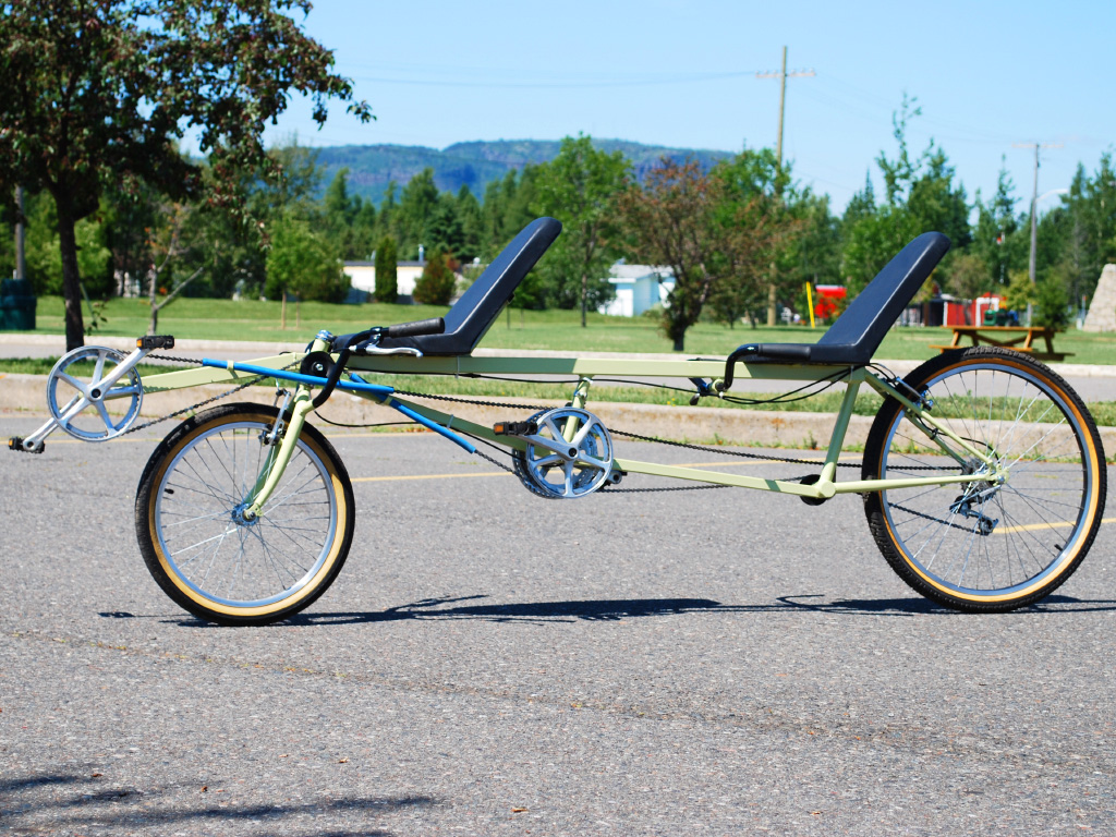

Warren's bike, of course, is a unique solution that arose from a unique situation. He already had the tandem. No longer needed it. And realized that trying to sell and ship it was going to be a hassle. So he made a home-brew DIY recumbent cargo.
I've been thinking about building a version of this Atomic Zombie bike that would be modified to be more like Warren's (shorter wheelbase, crank over the front wheel, seat in back, long reach handlebars).
https://www.atomiczombie.com/tradewinds-tandem-recumbent-diy-plan/
How a person build's it would determine how strong it ends up. Of course, build/weld quality becomes a big deal on something like this.
