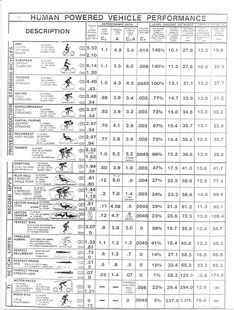

If you had a recumbent with a small wheel on the front and bigger wheel on the back, the geared motor is already 'geared down' in relation to the rear DD. So even if it's some wimpy 350w motor, it should be of a certain kV so that it can crawl you up a hill at ~15mph in the event that the DD fails.

I've never ridden a recumbent. It just seems to me like they'd be less stable and offer less bike control than a regular bike. I'm sure there's a good reason there aren't any recumbent MTB or racing bikes(though that would be interesting to see, and I'd watch the video).
Having ridden bicycles for over 50 years as an adult, and worked in bike shops the last 8 years of my working life, I can assure you that bicycles are a misery for the vast majority of people, which is why they do not ride them. The few who persist into adulthood, are rare exceptions, and most of them require pillows in their pants, padded gloves, cushioned grips, etc. to make it bearable.
As you say, you have never ridden a recumbent. That is the case for the vast majority of the few adults who ride bicycles. They get their attitudes about recumbents from bike shop "experts" like Chalo.

The other DD will continuously create a notable amount of drag, which will reduce your overall efficiency.
Until we can get DDs with 0.27mm laminations, or hopefully even thinner, there will always be some drag with DD motors. Even the smaller 27mm wide ones.
The really tiny low efficiency, low power density 250w DDs usually come with thick laminations and drag as bad as larger ones with thinner lams.
