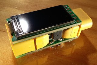

I assembled one of the display boards today. I've read that the LGA-16 package of the LIS3DH accelerometer is very hard to reflow without getting shorted pads but I gave it a couple of pokes once the solder melted and everything looks ok to me.
It wasn't really necessary but I stuck some multimeter probes through the holes on the LCD FPC to align it while I manually soldered it. I tested the display module with an Arduino sketch running on my nRF52 dev kit and it works. Now I just need to create an ST7735 driver for Mynewt.
Although the firmware development has been slow (as expected) I have implemented support for the display, accelerometer, shunt temp thermistor, INA226 current/voltage monitor and Bluetooth. I also assembled a second base and display module. The first device has a 0.5mΩ shunt and the second has a 5mΩ one. The devices are already at a stage where they're more useful than a GT Power Meter to me. Note that the display and web interfaces are just for testing. They will look much better later on.

Probably time for an update on this project. I've been working full time over the past year and haven't had much time to work on this. I might be able to start working on it again soon though.
There were a few hardware issues I ran into:
The reverse voltage protection didn't work. I've finally looked into it and found it was because I used a GDS rather than GSD symbol for the mosfets in my schematic resulting in them being wired in reverse. I'll fix this in my next hardware revision.
The display reset line needs to be directly connected to the MCU. The auto reset circuit didn't always work reliably and meant the display wasn't able to be hot plugged after the device was powered.
Waterproofing is hard. I've put in a lot of thought on how to waterproof the module. But having the bluetooth module onboard makes it very difficult. On a bigger board I could cover the RF module with a plastic bubble which is glued in place before potting. But that would cost a lot in terms of labour. I think this may be an area where I have to compromise and maybe make do with some conformal coating and a good case.
The LDO (linear regulator) can't supply the required current for the LCD backlight without overheating after a while. It is very resistant to failure and will simply switch itself off then turn on again when it has cooled down. But it makes the display unusable for anything above around 36V apart from a quick check. It also heats the whole device up to well above ambient temperatures which reduces the accuracy. My options here are to

I don't think I want to get rid of the display. It's very useful for a quick check without getting my phone out. Replacing the LDO with a buck module would probably work well. It would also allow higher currents for a bigger external display. The only downside is that they're a little expensive and would limit the device to 60-65V instead of 120V. Then again, anyone wanting higher voltage than that is also likely using more current than this model can handle. Implementing a software controlled buck could work but might be dangerous as a firmware bug or hangup could cause the backlight to receive the full input voltage. I don't have enough space for much discrete protection circuitry let alone the required inductor or even a stand alone buck controller IC.
The overall hardware cost is another issue. Using a pre-certified RF module adds most of the cost. A high accuracy shunt + INA226 combo is also expensive. The DC-DC module would add a fair bit to the cost. Using two boards instead of one (base and display) will increase assembly costs a bit but results in a much more compact module. The PCB assembly estimate I received from the NZ PCBA company was around twice the cost of the parts at 100 units (just for the base module) and even at 1000 units is not that realistic for a product like this. In order to produce this for a salable price I think I will need to have the SMT assembly done in China and then finish the hand soldering myself.

More updates. I've been working on reducing the BOM cost recently. My original BOM for the base module was around $25 NZD. I have now reduced it to a little over $7 NZD. I even managed to design a version that was only $3 NZD with lower resolution and accuracy (probably similar to turnigy/watts up meters) and no connecters but retaining most of the features including bluetooth and bidirectional measurement.
Most of the cost reduction was from replacing the certified RF module with a discrete nRF52 MCU. I realised that I would probably need to have a custom designed antenna to get the range I'm after and this allows me to look into encapsulation as well. With the additional FCC requirements in RF testing for products using pre-certified modules introduced last year, the savings of using a pre certified module are not as high as they used to be anyway. I am thinking of engaging an RF consulting company to help with the antenna design as my device is not exactly optimal in terms of RF especially with the metal backed display sitting opposite from the main board.
Other cost savings came from finding Chinese or Taiwanese replacements for some of the expensive components. I managed to find an almost identical 4 terminal shunt resistor for a fraction of the price of the equivalent part from Vishay, Bourns or KOA. I also found an LDO which I'm thinking of using instead of the Microchip one. It should have a slightly lower quiescent current draw and works down to 3V as opposed to 6V. The downside is that it only supports up to 80V instead of 120V. This is just under the 85V needed for 20S 72V lithium batteries. I am still looking at ways to increase the voltage capability or allow for powering the device externally to support higher (and lower) voltages.
