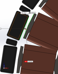

This motor is not a good motor (yet) the air gap is 3x as big one side of the rotor as it is the other.
The coils are not wound imbalanced like hummina suggests, but the out of balance magnetic field will be substantial.
I've suspected for a while that perfectly built motors are equivalent in star and delta (the inductance and resistance will mask small errors) but in imperfect motors, of which mine is a very very imperfect example, the Delta configuration effectively shorts those errors where the star lets them see an open circuit.

Those magnets look awfully wide in relation to the stator teeth, no? Or are pairs of teeth wound to be the same polarity?
Its all parametric, don'T remember might have figured wrong - all 3 phases up and down within each magnet cycle?

So after an extraordinary amount of time, a giant bearing I ordered on AliExpress turned up. So I knocked up a new thing to hold it and had a go
Also bought a new 3d printer... Revolutionary. Things now just fit first time.
The back EMF is better still (it's actually perfect) and it's about 70kV.
Lots of torque now.
Just need to print a new hub since the old ones horrid and oval, add some m4/m5 nut holders and rewind it with a full set of coils. Think I'll add an extra turn or 2 to get a better kV... 6 turn now, I'm thinking 8 turn is optimal. Maybe I can even put it on my bike soon.
