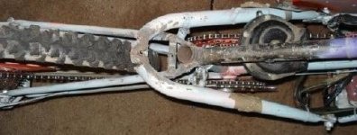

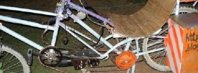

As for bending forks and structural safety, I totally forgot that on the CrazyBike itself, I'd used an old white "herculite" (whatever that is) steel fork off a Murray "Biotech", bent several *inches* wider using the car jack, as part of the main structural frame, for about half of 500 miles before reshaped it again removing the curved part and stem remnant, and the remainder still the rest of the 500 till I did my "bike diet" on it and removed them completely:
Crazybike1; it's the white frame bit from the rear seatpost curving down to the forward rear dropouts. It's spread about 1/2" wider than standard rear dropouts would be, bolts to outside of those dropouts:
Crazybike2; same place
Spread several inches further out to make space for the motor and chainlines:
Just before I cut the top "U" off to clear the new seat and stiffen the frame:
Just after:
I think it's safe to say it'd probably hold up fine if you widen it just a little bit like you'll need to. :)
