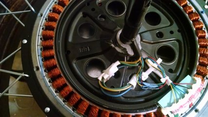

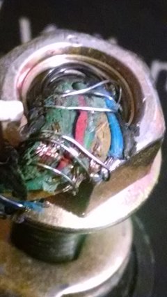

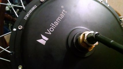

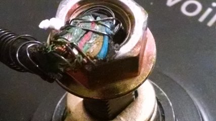

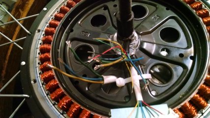

So it arrived.. and was damaged in shipping, the wiring was crushed where it went into the hub.
I can fix it, but it'll take a while. found pedal sensor and disk missing as well. Waiting on the seller to see what we will do. There are a couple of loose spokes as well, something else to learn...

That's really bad, IMO not worth fixing. Even if you get it to run, you will have problems later. Ask for your money back.

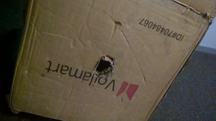

I'd love to see a pic of the box it was shipped in. Did it fall off the truck and got dragged 100 ft on the pavement?

Nice work on the wiring. If you can do that, you can put a couple of 12G spokes im, and get them tight w/o a tension gauge.
