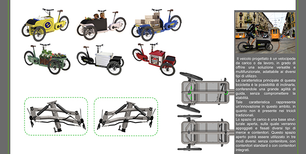

You can make your own leaning trike relatively easy, if you have the time and willingness to learn whatever skills you don't have yet for building it. ;)
There's a few designs that members here have posted, and a thread by Sk8norcal that contains a LOT of leaning trikes from various places, many (most?) of which are intended for at least some cargo. Lots of the pics have enough detail to reproduce the design yourself if you chose to (it might not be easy but it is possible).
For a somewhat silly idea you can look at my Loooooooongbike thread, which also includes some ideas for a trike version in delta, and in tadpole. I forget if I had the leaning stuff int ehre yet.
One cheap idea I no longer have both bikes to test with (one was stolen after the fire) is to take two identical rear suspension frames, and use the rear half of each to make the rear end of a leaning delta. Bars would cross between the two so that as you turn you lean over forcing the inside to go up and forcing the outer side to go down, and vice-versa. Sorry I don't have a clearer description or pic. :(
But then you could have a trapezoidal cargo box suspended between them, or attached to the bakc of the forward part of the trike.
You can also make one by using a regular "trike kit" that normally bolts to the rear dropouts of a regular bike, and welding or bolting a round flat plate to the front so that it can mate to a similar flat plate bolted or welded to the bike's dropouts. Then you can use a disc brake caliper mounted to the bike's plate, so that it fits over the edge of the othe rplate and lets you "grip" the plate with the brake, so you can lock it in an upright position for getting on and off, ro stopping, or whateve.r You could even make it so that it automaticlaly locks except when you are turning, if you want to make the mechanics for that. The trike part at the rear (delta) woudln't lean, exactly, but since most of your own wieght would be leaning over into the turn, on the biek part, then it would still help a lot in keeping you from flipping in a turn at higher speeds than walking. If you make the cargo box in the trike section as low as possible to the ground, and/or put all your heavy ebke stuff (motor, batteries) down in the bottom fo the box low to the ground, and/or angle the wheels slightly inward at the top, it would also help.

I would not count on that Noomad being an easy ride at all. I built a comparable trike many years ago, and it's a seriously frightening machine to master. The Noomad's front wheels may tilt in parallelogram fashion, but I'm guessing that it still will do nothing to promote harmony between you and your wife.
The following photos and description are from my old page at http://chalo.org .
This one I call the X-plane. The nylon BMX mags are marked "Stealth", the Schwinn Varsity frame is pure Cold War tech and style, and its riding qualities X-plain why more bikes aren't made this way! It's the result of some of my experiments about adaping normal bikes to cargo-carrying purposes. The tilt joint on the front axle is fortified with a pair of Timken tapered roller bearings, and the axle itself is a piece of drill rod that seemed pretty corrosion-resistant at first. I punched out the original bearing races in the mag wheels and pressed in some nice sealed cartridge bearings.
I fitted the X-plane with a longer than usual "fork" to buy a little more room between feet and front wheels. To get the bottom bracket back down to a more normal height, I replaced the original 27" wheel with a 24" coaster-braked unit. I originally equipped this bike with 14-apeed front and rear shifting, but one ride assured me that the bike would not be spending much time going fast, nor would its rider often have a hand free for shifting.
I don't really see what the tilting tadpole does for you that a traditional front-loading long john doesn't do with less weight, width, expense, and complexity. I'm certain I'd rather live with a Bullitt (expensive Danish 2-wheeled front loader) than with the expensive Danish 3-wheeled front loader your wife favors.
Chalo, don't know what to say. Never tried Bullit or The ButcherBike. So I have no idea how they compare.
If noomad is on par with the Butcher Bike or under par I do not know. I guess the only way to check if the Butcher is really working is to take a trip to Copenhagen to see and try it out in RL. And Denmark is never wrong, it is a great destination for relaxing. And I am certain I will get loads of points from my wife if we make a weekend out of it.
Trying to reason with women I gave up years ago. If she wants a trike her mind is set. A bullit would only be an option if it had 3 wheels. I am guessing it will be a struggle to even get her to accept a home made trike, and to suggest a 2 wheel cargo bike will be totally useless as it would not sink in. No matter how sweet it rides.
From the videos of the Butcher it sure seems like it is a smooth ride. I can't really see myself buying that trike just to take it to bits tough, price is too high. But I might be able to use a camera to get the basic idea. The Noomad on the other hand is priced like a tenth of the butcher so I don''t mind hacking it to try to force it and hammer it into a shape that fits my need.
Sure it might turn out a leaning cargo trike is not a doable DIY project, but I can't give in without even trying.
I expect that the Butcherbike probably works OK. Better than a bike, maybe not-- but fundamentally OK, probably.
The problem with the Noomad as I see it is the same as the problem with my X-plane. The wheels steer around the headset axis, but they aren't close to that axis. I'm sure the X-plane is worse, for various reasons: non-cambering front wheels, longer front axle, heavier wheels and axle. But the basic problem is the same.
The Butcherbike has what appears to be Ackermann steering with pivots just inboard of the hubs. When you steer it, the inside wheel won't move dramatically rearward as the front wheel moves similarly forward, like the X-plane does and to a lesser extent, the Noomad does too.
In a nutshell, if your steering system doesn't have linkages in it, it had better be steering a single wheel.
