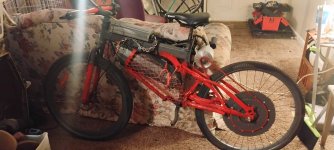

Hey everybody just letting you know know how it's going I've got 10 miles on it so far and not a single mechanical failure yet I was blowing fuses at first until I bumped it up to a 30 amp but I'm pretty sure that's not enough either because my BMS keeps triggering and cutting the bike off if I start to get a little heavy on the throttle. But in the meantime I can just take it slow and stack my chips until I can build another battery. There might be naysayers out there but I have to say I'm proud of it. I still go through my pre-ride inspections religiously and I'm pretty surprised nothing has failed on it if I'm being honest. Haven't gone over 25 miles an hour yet but I'm slowly pushing the gate as I ride it. got to find some taller handlebars though I feel like a monkey f****** a football with them drag bars being so low. But it looks cool so Price of beauty I guess. Thank you all for y'all's critiques and opinions and pointers I've taken each one of them into serious consideration. Except for the joke about the guy stealing it because he happened to need some duct tape that day, that was pretty damn funny.

Don't forget missing pedal.
You painted fork as well? Cool. (y)
Can't get the chainring to fit going to have to figure something out it keeps rubbing against the rear end because it's wider than it was thinking about maybe putting on a very small front chain ring with very short cranks and ill have to widen the radius of the chain path but it something that is on the list

You’ve been busy! The paint job definitely helps, and the foot pegs are a good addition.
Plus, the cage around the battery will keep those damn duct tape thieves away! 😏
You might want to start a build thread in the build subforum to document your progress/evolution. My first bike iteration wasn’t a thing of beauty, and I used my share of bungee cords and duct tape to temporarily strap parts to it while testing. A build thread becomes a good way to take notes on things that worked or didn’t, and to plan future upgrades.

Hey everyone here's an update on my build, criticism appreciated. Since my last pictures I swapped out the duct tape battery mount with a steel cradle I swapped the chain over to a bicycle chain I modified the rear sprocket with a track guide made from a brake disc and I added brakes to the rear
That tire ain't gonna hit the battery rack when the forks compress?
It won't if you get solid forks, probably.

I wonder if he dry-checked those forks bottoming out with that battery.
