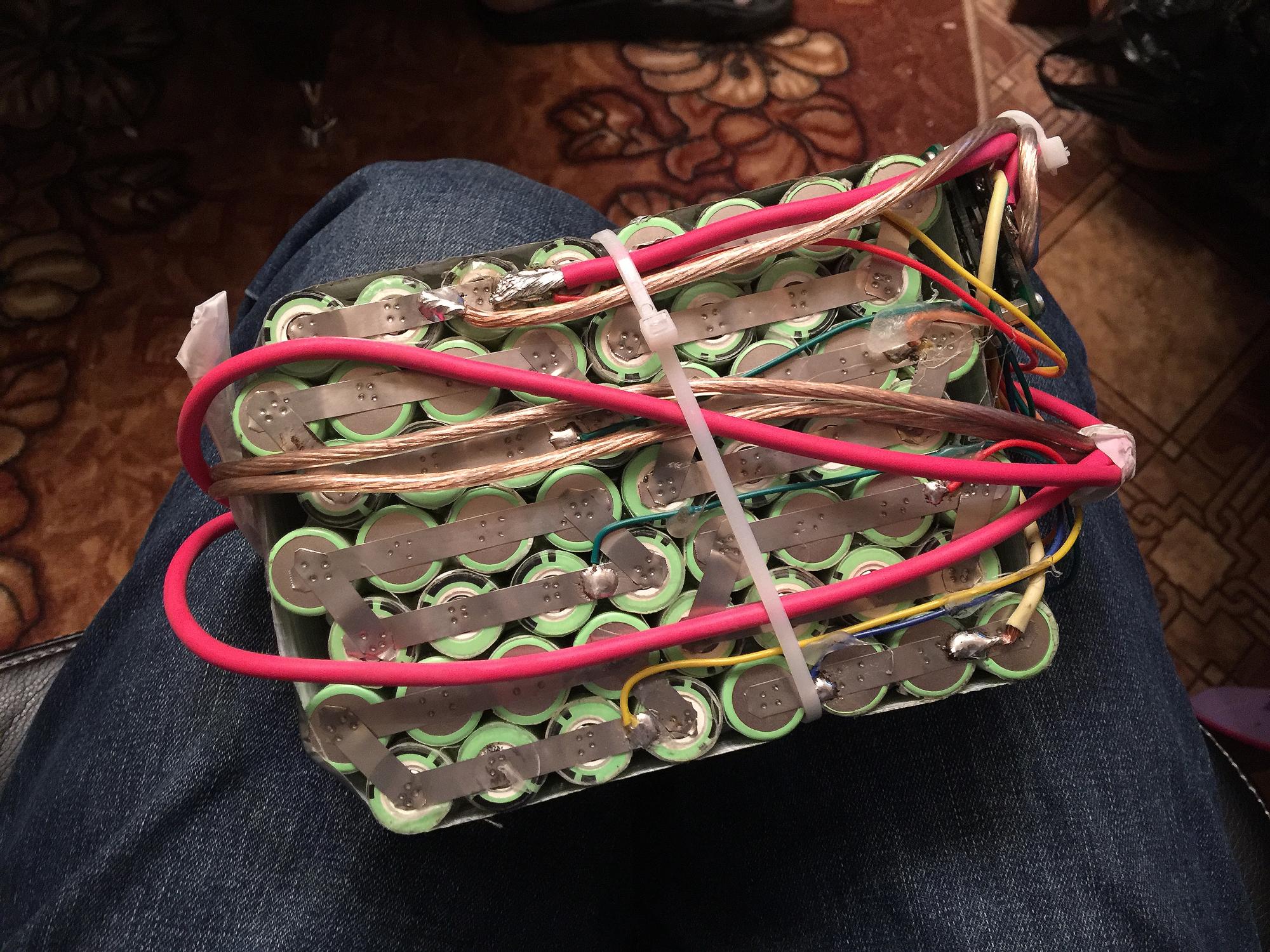

Here is an example of badly designed pack from china:
file.php
"The serial nickel conductors amount are not enough, but the main lead points are even worse.
Where the main battery wires are soldered, it that spots the nickel are completely in overcurrent. I don't see if they soldered more layers, in case that no, that points will heat the most in the battery, just check it."

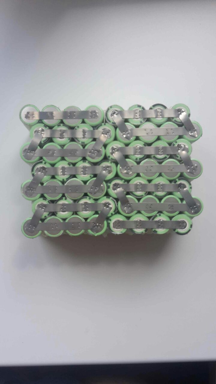

Here is a China pack with only two nickel connections!
I dont know why they do it, maybe to save on the nickel? If thats an issue they could've skipped the second long strip(because you don't need it) and add 7 more fot the series connection.

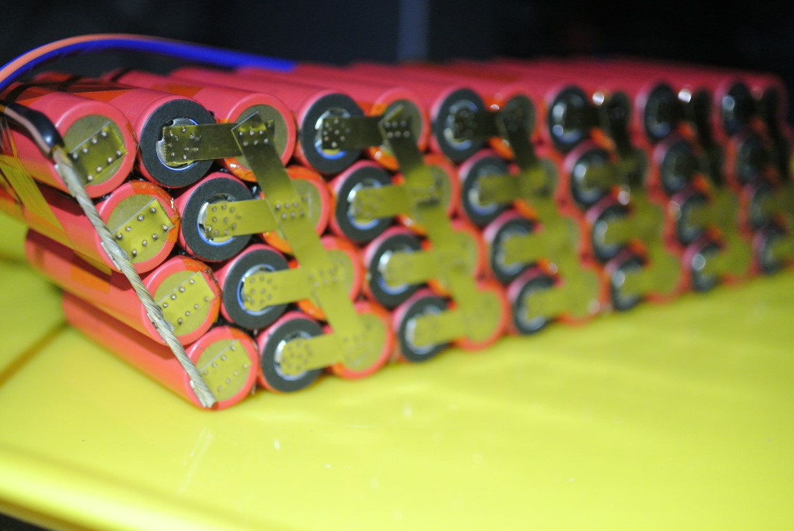

I copied maddin's design when I built my 24s15p Konion pack early last year. I think this design of connection is the best home made style. Mine was a hot glue design that worked well until I had a bad row and had to remove it.....that sucked. My next build will have the same layout but may just glue the individual rows together but not glue the rows to one another. I used .02 with 10 gauge throughout but will go 6 or 8 next time.
What I made works perfect except pulling almost 200 amps gets me too much voltage sag on my downsized 20s15p pack. 150 amps all day long though.

Great design litespeed, the best actually, but very time consuming and hard to weld :)
Next thing to talk about is how to terminate the ends in the best way, what is the optimal way of adding negative and positive wires to a pack to keep the an even current flow all the way to the wire?
