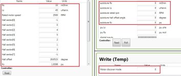

Fortunately the software has a good auto-tune feature that spins up the motor and determines the key characteristics like the winding inductance and resistance and so forth.
Sorry to be an absolute n00b, but does anyone (Not just Justin) know where this Auto-tune feature is? I think I've clicked on every tab and not found it. Is he referring to the version of the software on his website, or an older one he was playing with, when he posted this ages ago?
Sunder said:
1st, Write 1 in Motor discover mode and will get Rs & Ls;
2nd, Write 2 and will get RPM, Kv, hall sector, hall offset...
Thanks so much :)
