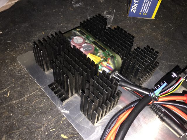

Is this overkill? Would I be better off to use thermal grease between and bolt everything to the plate, or jbweld those heatsinks to the plate and bolt the controller between?
Doesn't look so small now.
Does heat travel through ALU corners as well as non bent stuff?
I'd be thinking folding it U channel style to fit around your downtube, so it doesn't stick out so much. Or even curved if the down tube is more cylindrical than rectangular. Just flattened at the mating point.

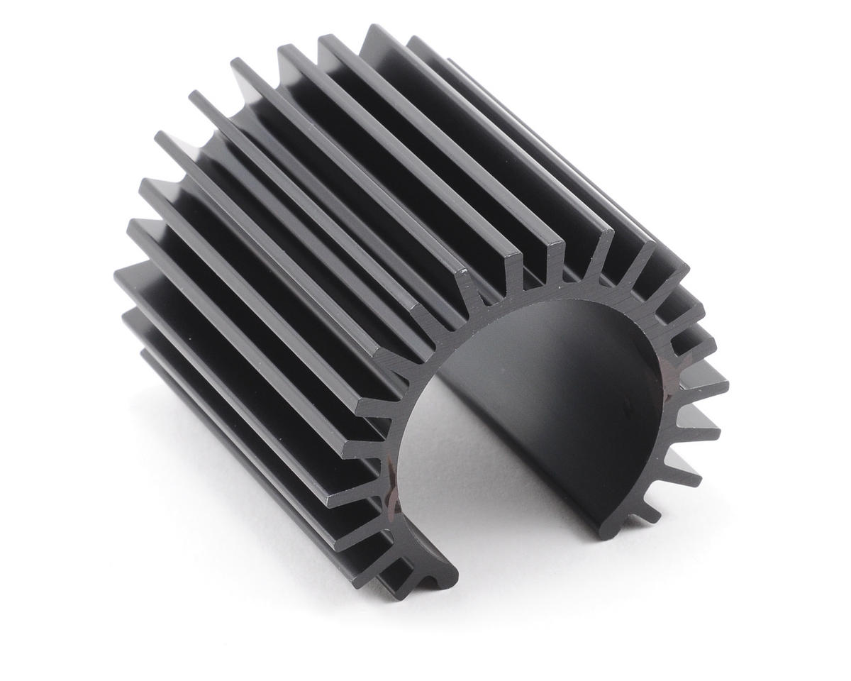

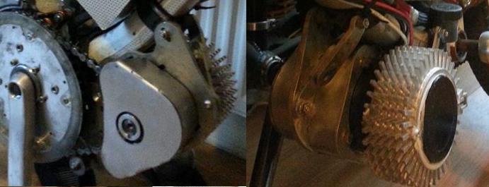

AFT motor
RC motor heat sink
could cut of fins and flatten the top maybe?
that sheet of ally looks rather thin... that'd be my main concern - all the heatsinks you have wont be able to do as much given that there's a high-resistance path the 'heat' has to travel through. use some 5mm plate or similar (assuming that the picture isn't just tricking me that is!) and it should work a lot better...
