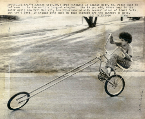

On a chopper, a strong front brake can be just about as dangerous as insufficient brakes.
A triple clamp fork set up low over the tire can use strong front braking. The stretched chopper forks I’ve had can’t use strong front brakes to their potential, though. The front wheel skids from anything more than moderate braking. There isn’t enough forward weight to stick the wheel to the ground during forceful braking. I usually use a drum brake, or a caliper, or no front brake. Most of the braking should be on the wheel where most of the weight is during deceleration. On most choppers, that’s the rear. Thus, many don’t have front brakes at all.
babes+ride+out
A bike frame that hasn’t been built for a chopper fork can get even squirrelier from front braking, because the long fork tips it back and places the rider’s weight even farther over the rear wheel than normal.

I don’t think any of my own choppers have had forks more than about 25” from axle to lower headset race, but they’ve all been willing to skid the front wheel at inopportune moments when I grabbed too much brake.

That's why you cut the top of the fork tubes and adjust the triple clamps so it has the same axle-to-crown length as the original fork. I assumed this would've been understood, but it's very good that Balmorhea pointed it out. The frame on my chopper was designed for a long fork, so it works pretty well. It's not obscenely long, and there is still plenty of weight on the front contact patch because of the motor in the front wheel.
