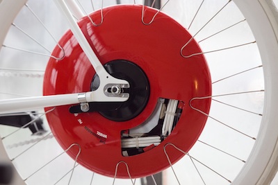

I'm not sure what to think about the spokes. How are they connect to the hub? It doesn't look like a weld... I can't tell.
If anything, I'd be more worried about the spokes braking, especially since I can't tell how it would be repaired.
Looks like they loop around within a groove in the casing. Seems a reasonable idea to me.....

the spokes are cool but hhhmm you ding one and 2 go
I agree.
Here are my concerns:
Under spoke tension, will the looped spoke pull out the grove/cut in the casing? That would render the sidecover useless.
When a spoke snaps, where do you go? No bike shop will have them, so you carry an oddly shaped 'boomerang' spoke in your hip pocket?

It seems to me that the tension on a big U-shaped wire would equalise or balance somehow when the wheel is subjected to shock.
It would definitely "seat in" in the drive direction just like normal bicycle hubs and spokes.
You can't even obtain or replace the spokes in many of the low spoke boutique wheels flogged to today's roadies.
There's nothing to suggest the so called "Copenhagen Wheel" is ready for prime time. That it spurs bicycle development is good, IMO.

They are managing the lipo pouches with zip ties and sticky tape
Yeah, that's gonna come apart the first day in Phoenix's late spring, much less summer. :roll:
Also, what if you don't ride often or hard enough to regen enough to charge the battery more than all the fancy electronics use up? With no external charger, you can kiss your expensive investment goodbye. :evil:
I love the look, and I love the electronics. But WTF? Theres no way this thing is more efficient than a conventional bicycle. Wayyy too much mass in the wheel. I would like to incorporate some of the electronic gizmos into my bike though....
