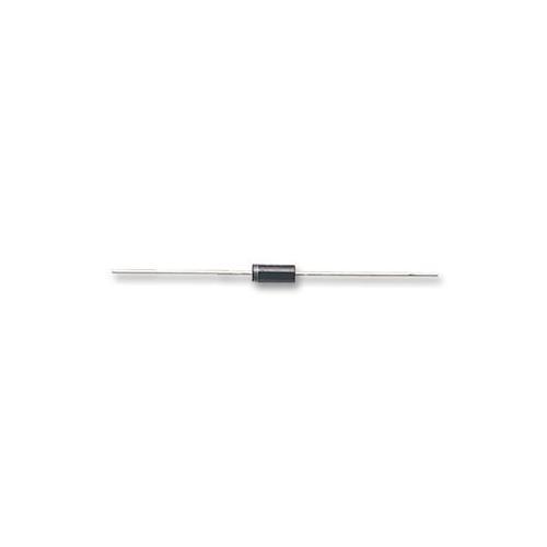

As for the diode, would this one work well?
http://www.ebay.com.au/itm/GA58663-VS-MBR360-Vishay-Diode-Schottky-3A-60V-/141246169128?
It's only 3A, but between the panel and DC-DC I will only push a max of 1.5A and from the DC-DC my battery a max of 0.5A.
I won't be able to move it into shade if it gets hot as I plan on leaving it unattended outside during the day, while I work. How hot are we talking? Could I heat sink it to my aluminum frame?
Stupid question, but how do you know which end is which for current flow?
Cheers
That one looks like a good choice.
Here is your data sheet:
http://www.onsemi.com/pub_link/Collateral/MBR350-D.PDF
Installed between the DC-to-DC converter and the battery it will see no more than 0.5A -- from the data sheet the voltage drop will be ~.37V which will give you a dissipated power of < 0.2W. It should be fine almost anywhere you put it. If it is easy to heat sink it to the frame that would be WAY more than enough to keep it nice and cool.
With regard to which way diodes go, the symbol makes all clear:
Current flows from the unmarked end toward the end with the band. So install it in the positive leg (between DC-to-DC and battery) with the banded end toward the battery or in the negative leg with the banded end toward the DC-to-DC converter.
In a world FULL of counterfeit semiconductors, be sure to test it with a multimeter to be sure it IS a diode -- low resistance in one direction and high resistance in the other. Or even with the small battery and the bulb from a penlight. Current should flow in the forward direction and NOT in the reverse direction.
As long as it is a diode (current flows only one way) and it doesn't get very warm, then it is fine for your application.
When you hook it all up (panel, converter, and battery) and take it out into the sun you will find that the DC-to-DC converter loads the panel heavily and will probably pull it well below your V(max power) as the converter tries to get to the set-point voltage. As the battery fills, the load will drop and the panel will run more efficiently. An MPPT controller of some sort would make this better, but I don't know of any that are reasonably priced.

The diode I posted previously was no longer available so I ended up getting this one:
GA58635 SB3H100-E3/54 Vishay General Semiconductor Diode, Schottky, 3A, 100V
http://www.ebay.com.au/itm/141246169158
I'm hoping it's just as good (or better), but after looking around for ages I'm really not sure...there seems to be a multitude of diodes available that would do the job...can anyone confirm the one above is ok?
It will get warmer than the VS-MBR360 but should still be fine with your 0.5W current. It is going to dissipate around 0.4W in the worst case. The junction is going to run about 25C above "ambient" . Just remember that "ambient" is the case temperature so don't bury it in a lot of electrical tape. If it is convenient, put heat shrink over the leads right up to the body and leave the body uncovered and "out in the breeze". Or heat shrink the leads and tape the body to a metal surface like a rack or the frame.
Thanks for the feedback. Glad these will work then.
The hottest air temp where I live would be 40C ambient + sunlight heat, which I'm guessing could be +20C worst case. So max temp of 85C at the diode in operation. They are rated for up to +175°C so I think it should be fine. I will just have to ensure it's not buried as suggested.
