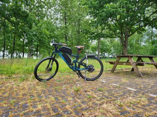

Ok, I made an important mistake here. I had measured the space within the triangle, and the very large 52V battery pack should fit exactly. Well, when I put the pack inside the triangle, it did fit, but I would never be able to remove the battery pack from the bike to charge it. I
You've got a lot of clearance on that bike, too. Depending on your riding style/terrain, you could consider mounting it under the triangle (ie, hanging). Plenty of setups do this without too much hassle, and bringing that weight down is a big plus.

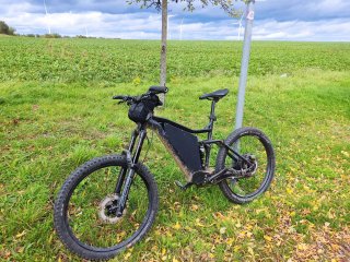

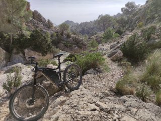

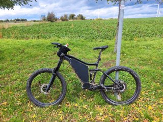

i have a similiar setup, Full suspension with Grins all axle but in standard winding, phaserunner and CA. it "was" originally a chinese bafang ultra frame, but after errors and fails with bafang i gave up and ordered the Grin Products, i had to weld a BSA bottom bracket "adapter". The phaserunner is in the place where the bafang motor was.
you could build a triangle battery case and put the phaserunner in there and make all the cables more hidden but it wouldnt be removable.
i have fitted a 154cells battery, 14s11p with 18650ga cells in this triangle. its not removale because i only charge at home or at the camper van and a removable case is more complex.
here is my setup shortly after i finished it months ago and one picture with the bafang ultra motor. i now have front and rear schwalbe johnny watts(great tires) and a front fender. my torque arm is also in the wrong position on this photo, it had to move to the upper part of the swing arm.
Also an excellent idea. I will do hardly any off-road driving, and definitely no jumps or rocks. Therefore, I will first try the mounting under the triangle idea. Thanks!
Nice setup. However, for me the removal battery is non-negotiable, due to the frequent charging in house and in the office that I need to do, whilst not being able to bring the whole bike inside. I thought about putting the phaserunner somewhere hidden. However, the thing gets hot, and I like that at least part of it is in the open to manage the temp.
To allow removal of battery under the triangle (for charging indoors). What about using magnets backed up with a velcro /bungee that provides the holding power? Magnets just has to be strong enough to hold the battery in place while you attach the bungee.
