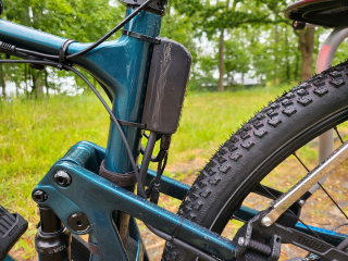

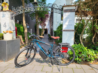

I had ordered this FS MTB for EUR 1'999.00 and it came in earlier this week.
Key specs:
  • 29inch/700c (ETRTO 622) wheels.
  • Formula Cura X brakes.
  • Rear axis 148x12mm.
  • Fox 34 front suspension fork.
  • RockShox SIDLuxe Select+ rear suspension.
  • Large triangle.
  • Carbon frame.

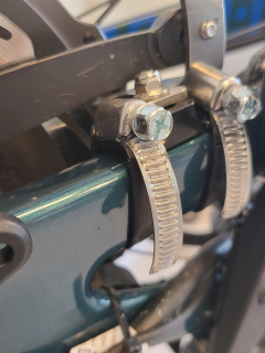

I am aware that the carbon frame is the "weak link". I will use the Triple Bob with Hose Clamps to securely mount the battery onto the downtube of the frame, so as not to rely on the eyelets only. The battery is 5.38 kg according to Grin, therefore I believe that when it is well mounted, it should not be a problem for the carbon frame.
The tires will be replaced by Schwalbe marathon plus MTB performance 29"x2.1 tires rated for E-bikes up to 50kph.

Looks nice but what was your rationale for choosing a carbon frame?
Mostly weight. But it was also part of the package for the most cost-effective FS MTB with good groups and good brakes.
