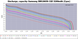

When I asked Paul to get some higher density cells, and he got Samsung SDI INR18650-32E
36V 9.5Ah (10S3P-32E), 25A BMS, 75*101*130mm, 1.59kg, 340 Whrs
Nice, small, and light weight. Yeah, some 3400mAh or 3500mAh cells would have been nice...
My LiFePo4 weighs 4.5kg, and has the same range on my bike. This battery is 1/3 of the size and weight!!!
This compact 75*101*130mm 1.59kg battery could be put near the lower bracket, in a top tube bag, or under the seat. Given its light weight, placement isn’t as critical as a 10-20lb battery. Nice that battery technology as enabled safe builds that rival LiPo in size and weight.
Hello Chas
That is very light. My 12s 5ah pack made from HK hardcase's weighs more. They list 598g per 4s brick. Call it 150g per cell, and you need 10 to get 36v so there is your 1.5kg but it's 5Ah and yours is 9.5 so your coming in at around half the weight of RC Lipo. That is certainly news to me! :)
edit: I think the 598g listed is wrong, and it's more like 535g making my 12s 5A weight the same as yours with it's ~30g bms. Still about the same outcome though. I'm off to look up your cells :)

Ron has some interesting batteries in this article, but I haven't found many packs used with these.
https://www.electricbike.com/18650-cells-for-e-bike/
I see the 4s hardpack is 28 euro's making them 7 a cell. I see your cells at 3.5 Which is another nice multiple. 6.4Ah of yours buys 5Ah of Lipo. So your cells are maybe 20% cheap, 45% lighter and somewhat safer.
RC lipo still has the discharge rates and ease of packaging on it's side. I'm not sure about volumetric efficiency. I see your cells are 10 amp and another popped up at me that manages 15 amp. Making your 3p pack enough for an s12s, or a 2p pack could cover 250w standard bikes. Without switching to the 15 amp cells that could do a 250w bike at 1p. I think a lot of people would make the switch if they were just easier to assemble. Tabbed perhaps so we could solder them.
