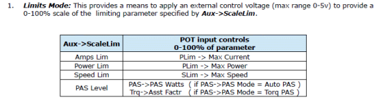

G'day folks,
I try to set up the CA V3 with a Thun Torque Sensor and an external poti in a way that the amount of support by the motor can be adjusted with the poti.
What are the settings here?
I noticed that Prelim 5 has the 'PAS LEVEL' setting eliminated - wasn't it here that I could achieve this?
Thanks for your help
I noticed that Prelim 5 has the 'PAS LEVEL' setting eliminated?
The setting of "PAS Level" is still there in the Aux limits menu, perhaps you skipped through it without noticing? If you have a torque mode PAS, then this will scale the assistance from 0-100% of your assist factor setting. If you are in AutoPAS mode, then it will scale the background watts you have while pedaling in the same manner. -Justin
