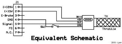

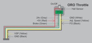

I doubt those are temp sensor wires on the throttle connector - probably ebrake. Here are a couple of threads and a couple of snaps from those threads:
Lyen 18fet to Cyclone 1000watt Instructions
Headline Motor & Cycle Analyst with limit functions
Frankly, there does not appear to be a return to the controller for either Vbatt or +5V -- so the switch cannot reasonably be switching Vbatt as it does with other controllers and cannot be switching 5V back to the controller either. The Vbatt connection appears only to be used for the fairly worthless gas gauge LEDs.
So how does this thing work? Oddly, both of the images above suggest that the throttle on/off switch actually controls the power for the throttle electronics - which apparently kills the throttle signal but does not actually power down the controller - again, kind of worthless. On the other hand, if the switch actually does interrupt Vbatt, then it makes sense that the CA-powered throttle electronics would flash the LED when the controller power went away. (?)
So - something is wrong either with those illustrations or guesses as to how this thing works.
The operative word here is 'Guesses'...
Anyhow, if the illustrations above are sort of true, it appears that some bit of throttle electronics and the LEDs are drawing power from the CA throttle +5V supply and that is what is causing the change in the CA backlight when the LED blinks.
