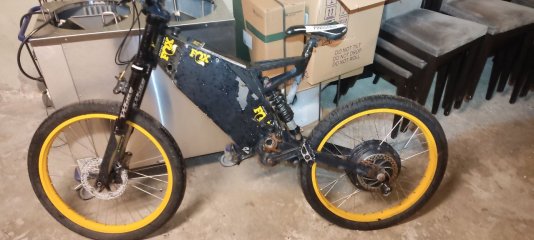

I recently met this bike builder online. I was looking for a battery for my first e-bike build and had bought the QS203 with fardriver 72450kit. So this guy tells me he has a new original b52 battery pack that is worth 1500$ he is willing to sell me for 750$, this was initally over my budget but i told him i was gonna consider it. So I went online and read all about the B-52 and I was sold. So I told him ill get the battery. Then he tells me I can buy his original Stealth B-52 for 3500. It just need assembly as he have packed it away. Having seen all the videos about the bike i said sure thats a great deal. So I used my 2 next pay checks and paid for it even though he didnt send me any picture of it yet but he assured me I was getting a killer dead that just the shocks and reg nr is worth 3500 alone B052 is kinda cool. So the day i pay he of course just happend to have to travel away for a week. Then when he back he sends me this photo:514666069_1259302418989865_8642288275768627158_n.jpgI then straight away tell him that that is a frankenbike and that i dont want it. he say i have paid for an original b52 so thats what he will send me, with a battery of course. I tell him if i get something that was not agreed then I will press charges. Then today i get this: A bike without controller, broked break wheel, seat is loose, wheel forks looks welded. overall i dont know if i should cry or laugh. He insist its an original because of the number plate. I am wondering if he is correct because of the gearbox. I havent seen any other bikes with this kind of gearbox. But this bike doesnt even have a chain. And yes its was stupid to pay before i see anything, but he doesnt live that far away and he does build ebikes for others. So i figured 3500usd is a good deal. so please help me.. is this an original or some kind of frankenbike? and is there any point in trything to get it back in shape?and how much is it worth in this current state. He also sent me this "original new" battery. looks swollen and not original to me... any input is appreciated!!!

Well, I'd say you've been scammed, but you already know that. :(
That first image is from some previous period in this bike's history, if it isn't of a different one entirely. :/

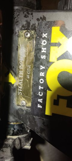

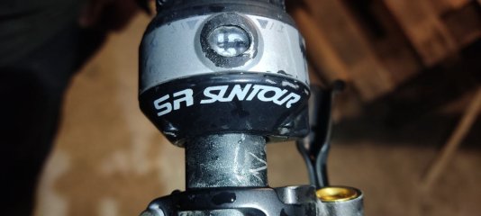

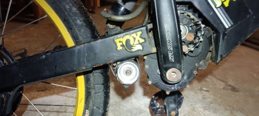

You can check with stealthbikes in australia to see if it's the genuine bike or not, and possibly even what it was originally configured with. IIRC the Stealthbikes came with the Pinion gearbox in the BB.

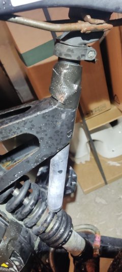

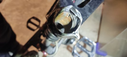

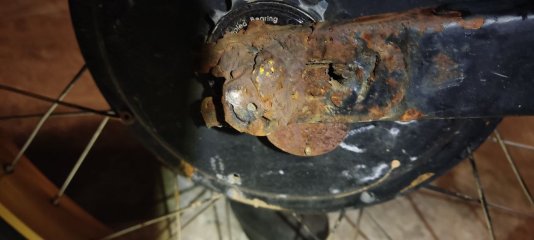

The motor axle looks like it was welded to the dropouts for whatever reason; if you have to service the wheel, replace a tire or tube, etc., you'll have to cut the welds or the frame. Personally, given the visual indications of cracking in the frame there, I'd be inclined to cut the entire dropout section away and replace it with something custom built for it that does the same clamping job. You could probably grind and file the weld and axle nut away precisely enough to allow still using the existing motor in the new dropouts.
The rust on the frame in various places (other htan dropouts) might be just surface, but you'd have to examine it for pitting, cracks, warping, flaking, etc., to see if it's structurally compromised.
Honestly? Probably not. Most of those parts require maintenance and repair that will take more time and effort than they're worth. The swingarm is trash, and by extension, so is the motor axle since it's all welded together. That means you need to do a motor axle replacement and find a new swingarm. If that was the only issue, it could be worth it, but then the frame itself is heavily damaged. Basically even if you cut this up for parts, even the individual parts don't have much value.
I'd instantly message the seller stating that you want to return it and cancel the transaction for everything that he sent, and check how the law treats cases of buying used items sight unseen. If you have no standing to formally cancel the transaction, maybe you could bargain with the seller to get at least something back to minimize the damage. In that case take the thing apart, sell all the parts to get back anything you can, and start saving up for a better deal next time.

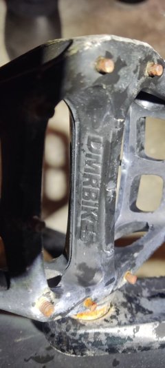

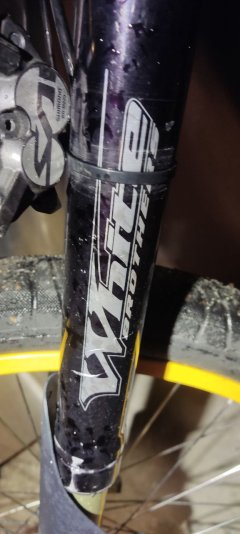

First Clean this thing real good und Wire brush off the rust/Paint/Dirt so you can really see what you dealing with. Rust and dirt is deceiving.
Then Take this thing apart and inspect the Parts you got.
In the end these bikes are made off steel, a angle grinder and a welder are your friends
(In my twenties I bought old dirt bikes, restored and then sold them. I've seen much worse than what you have here.)
Doing that means the seller certainly won't take it back. If there's a chance to get money back for all of this, it probaly requires not touching anything.
