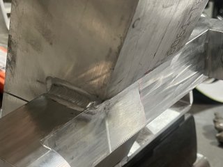

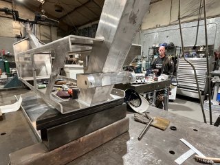

Welded in the swingarm mount today.

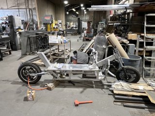

You can generally run 40-50kw on those "5k QS motors" for 10 sec bursts. I do on the QS165s (both the 5kw version and the 10kw).
Thats s ton of frame and battery weight. For a drag build you want it to be as light weight as possible generally. Might look into LIPO cells. They are by far the most energy dense for their size. My 128v pack is only 15AH and will dump 330a (max line that 96680 can do) easily in a 28s3P (12 5ah 7s packs.) configuration. The pack is just under 25lbs. 200+lb battery seems crazy on a drag bikle to me. My bike is about 110lbs w battery for refrence.
I typically just us a $30 balancer and skip the BMS. Use the software to limit current. That 96680 will do 28s no problem I ran mine at that for years. I will say FD hard limits phase amps at low RPM. So they make for pretty poor all out drag setups. Still fun to play with but you want a modified FD or upper end Moxin or Kelly if you really want lots of launch Phase amps down low.
Good to hear about the peak capability of the QS motor. You have a good point about battery and frame weight. The frame is pretty light weight being all aluminum. The power density of the battery is not the best but, the peak amp capability is incredible. 1,200 amps at 28S is scary. I just call it a drag bike because of the way it looks right now. I am happy about how robust the battery enclosure is. I will not fear the bike falling and damaging the pack. It is my first attempt at doing a real quality build. I've built other projects but not to the level I could be totally proud of. With my current build, I've left plenty of room to upgrade batteries motor and controller. I'm also proud of the build so far. Thank you for chiming in. I appreciate your input.
That frame and all look top notch. Don’t get me wrong, that’s beautiful work! 140kw is def. nothing to sneeze at! I think it will sag pretty heavy on ya at 1200amps though. At 200A, I saw about 15v of sag on my 20s1p SPIM08 pack (only 8ah). Great little pack though. It took a beating regularly and never had an issue.
Was only mentioning you could get by with a 87% lighter bat to max that controller and motor if drag racing was the goal. That controller only takes 330 line amps. You’re gonna fight traction more than anything with that skinny tire. Hubs are def the power kings, but its a constant battle trying to get any of it to the ground. That setup looks like its screaming for a 26x10” slick and 2 giant mid mounts to me. ;)
Best of luck with it!

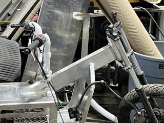

I mounted the remote handlebars. Steering link rod tomorrow.
