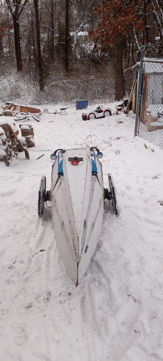

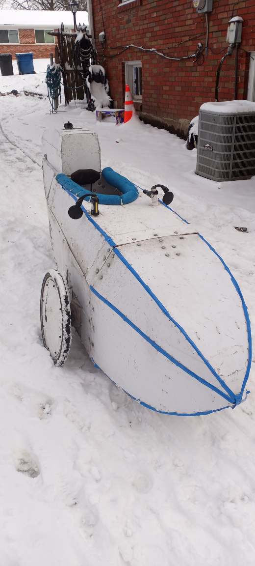

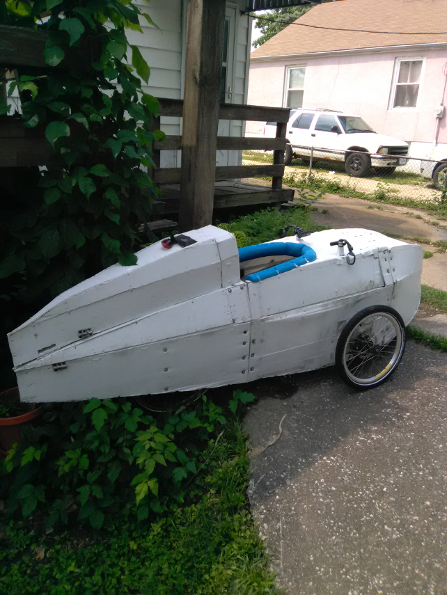

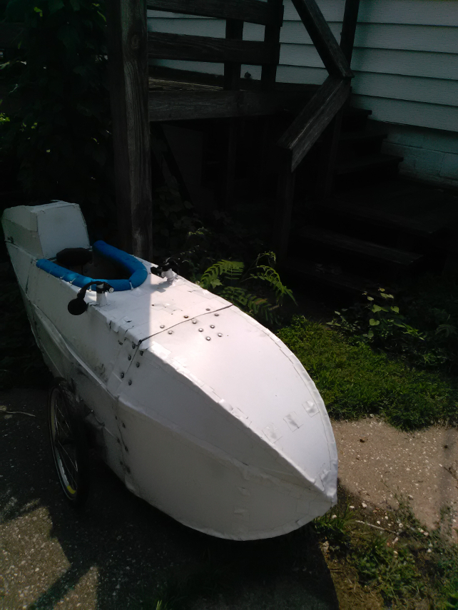

Pics of the bike:

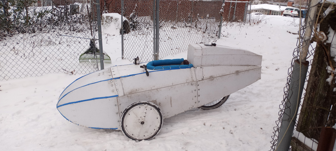

So far here's the realized specs:
-46 mph top speed on flat ground on a full charge with the motor enabled
-1,500W peak power, plus rider effort
-7 watt hours per mile @ 30 mph w/light pedaling
-9 watt hours per mile @ 35 mph w/light pedaling
-12 watt hours per mile @ 40 mph w/moderate pedaling
-12 watt hours per mile in the snow with enough effort to do 30 mph on flat ground, but riding at speeds from 20 to 40 mph with a 20 mph rolling average
-While powered yields a consistent 40-50 mile range with enough effort to cruise at 30-35 mph on flat ground in freezing weather. I get about 8.5AH from the 46.8V pack in the cold, although it is rated to 10.5AH. This should improve to perhaps 60 miles range at the same speed in warmer weather due to reduced air density and increased battery capacity.
-With the motor disabled, I can pedal it to 35 mph in a sprint and cruise on flat ground around 23 mph. I lost a few mph unpowered after installing the motor due to its additional weight and cogging losses.
At any operating speed with which it is capable, it feels stable and tracks straight. It has been up to 60 mph downhill before I motorized it and felt stable. It is very controllable at 30-40 mph in 30+ mph crosswinds with 50 mph gusts, although one will need a bit of effort to keep it straight in those extreme conditions.
Regarding what specs this will eventually have, I'm in the process of building another battery pack. It's going to be 72V 21AH, capable of delivering 5 kW peak, and is liable to give me a 150-200 mile range @ 30-35 mph, acceleration like a car(simulation shows 0-30 mph in about 5 seconds with a 96A phase current, but a better controller and a 150A phase current could allow 4 seconds), and a 70 mph top speed. I’m also going to finish a set of wheel fairings, a windshield, roof, and rear wheel cowling to cut drag further. I also plan to add brake lights, permanent running lights, headlight, and turn signals, as well as solar panels and a charge port for electronics. Later upgrades may also include hydraulic disc brakes, thicker brake rotors, and perhaps a rear suspension.
Here's some additional specs:
-Weight: 82 lbs
-CdA: Unknown
-Trike Frame: KMX framekit
-Body shell: Custom corrugated plastic bodywork with aluminum ribbing, mounts, and supports
-Battery: 46.8V 10.5AH pack of 13S3P Panasonic NCR18650GA cells, 490 Wh rated capacity, 1,500W rated peak power

Dauntless said:

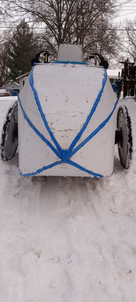

Are you sure you want to go 46mph in that? NO protection there.
Of course I do!
What I don't want to do is WRECK at 46 mph, or really any speed for that matter. If one were to jump off of a 6 story building, they'd smack the pavement at close to 46 mph.
I see people with tadpoles who have a flag above eye level for the cars.
The wind points the flag straight back minimizing the visual cue exposed to any drivers from behind. My vehicle has about the same ride height as my electric Triumph GT6, and is about as readily seen. The flag in my case would be next to worthless and add drag. The real threat is boobus Americanus not looking at the road and texting on their phones.
How are the steering and brakes?
The steering is perfectly adequate, although an inexperienced rider might find it a bit "darty" since it is direct steering using the stock KMX steering bars. I keep my hands on both bars the vast majority of the time, and one must be mindful of possible loss of control with only one hand on the steering if road imperfections are encountered.
The brakes are solid and will panic stop reliably and straight up until about 35 mph with minimal worries, with my once a month inspection/adjustment. They get a bit questionable at anything faster than that, although I have done a panic stop at almost 50 mph before I converted it to electric. I was careening down a hill on State St into East St. Louis when the light at the intersection suddenly turned red with only a 1-2 second yellow. I had about 200 feet to stop, and got pulled towards a minivan in the next lane over at the first application of the brake lever, and had to carefully modulate application of the brake while adjusting my steering to stop quickly enough to avoid going through an intersection with 50 mph cross traffic, while at the same time avoiding a 3 foot concrete wall/divider/median on my left, and a minivan at 40+ mph on my right. The next chance I got, I pulled into a parking lot and re-adjusted the brakes, after letting the rotors cool down.
Installation of hydraulic brake calipers and dual-pull lever will correct this because of their self-balancing tendency. That is on the list of things to upgrade to when finances permit.

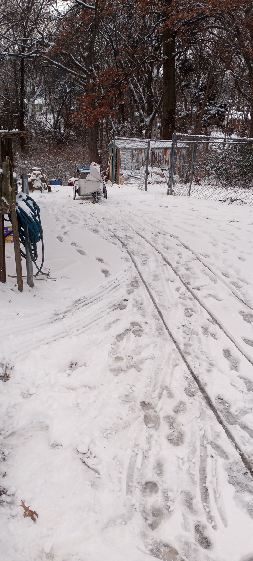

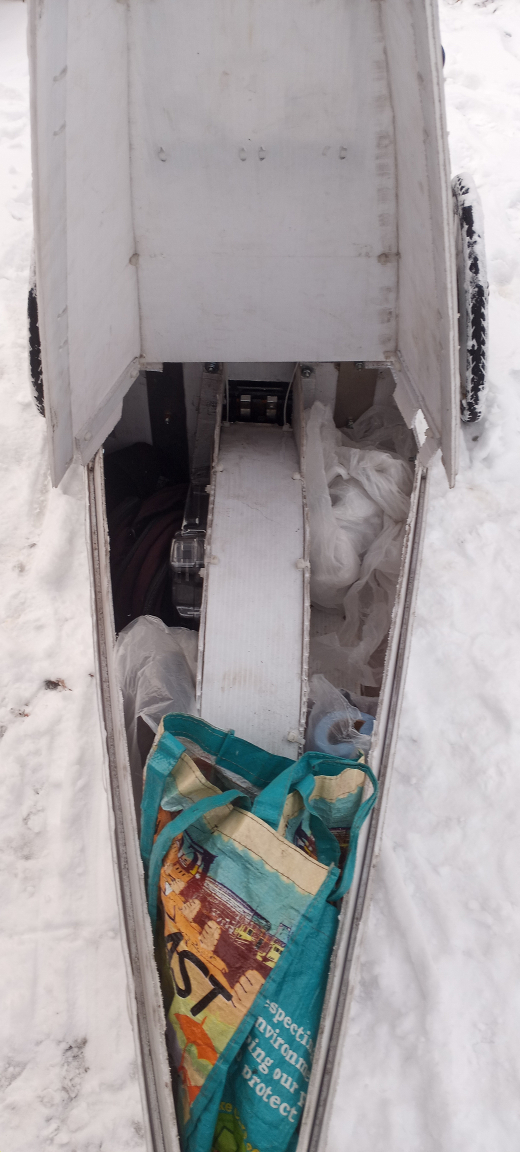

And the third pic. Is there another vehicle in the distance?
It's a plastic child's toy car with an open bottom, no pedals.

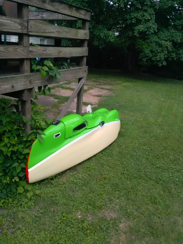

I bought a Milan SL:
I just need to find out where I can get a MAC 6T, because they seem to be discontinued. Any suggestions on a geared hub motor with a clutch that can decouple the motor from the pedal drivetrain? A GMAC won't work. If I'm going to have to deal with cogging losses, I may as well order a Leafbike 1000W with a 3T wind.

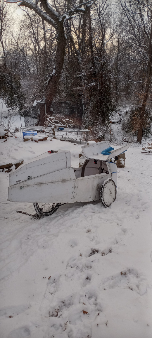

Here's some more pics of the custom build, which has almost 9,000 miles added since conversion to electric in January:

I bought a Milan SL
That is nice, well done.

About to order a rear suspension and take this KMX out of commission for a while. It will be back in commission minus body shell once everything is installed, and I'll need to go through the laborious process of re-designing everything to accommodate the new specs imposed by the upgrade. It will be more reclined with a slightly lower center of gravity, slightly smaller frontal area, and a 2" longer wheelbase or more. Looking to install Mitas MC2 16"x2.5" tires on all three wheels, will be swapping out the 4T 1500W Leafbike motor built into a 26" rear wheel for a 3T wind 1000W version built into a 16" cast scooter wheel, adding hydraulic disc brakes for the front wheels with a cable pull emergency brake on the rear, and will be running a 20S7P pack of Panasonic 2170s. I'm getting the freewheel version of the motor to keep the axle length the same on each side, and will be running a DNP Epoch 34-11T 7sp freewheel, and adding a Schlumpf HS drive with a triple crank up front, and replacing the torque sensor with a model that accurately reads the torque at the crank, and not merely estimates it based on tension.
The new body shell is going to resemble a sort of cross between the DF velomobile, the WAW, and the Milan, and I have a Milan right in front of me to reverse engineer. Hopefully I get it efficient enough to cruise at 30 mph on 250W, 60 mph on 1.5 kW, which would be about 2x the drag of the Milan. There will be at least 150W of flexible solar panels on it. Aiming for a slightly higher 5-6" ground clearance with the exception of the chain tunnel and rear derailleur cover.
IF it proves to be too cumbersome to pedal with the motor turned off, I may remove the bicycle drivetrain altogether, install some Grin all-Axle motors up front, strip a Hubmonster out of a scooter for the rear wheel, and turn it into an AWD hoonabout with ridiculous acceleration. We'll see. I'd prefer to keep it a pseudo-bicycle and retain the bicycle functionality so that there's never any range anxiety and so that it is versatile(after all, there's a lot to be said for not being reliant upon the EV drive to use the vehicle), but if the bicycle bits prove to be decorative instead of functional, then it's of no use to keep them.
