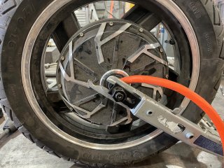

Frame is coming along just fine. 1/4" aluminum. The Ebay swingarm from an '86-'87 Honda XL600R is arriving tomorrow. It has the 200mm dropout width I need for my QS motor. I forgot to weigh the battery today. I'll do it tomorrow. I'm guessing the weight will be about 120lbs. without the CB/contactor/fuse/Terminal block assembly

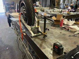

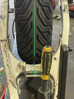

Aligning the rear wheel to the swing arm. I don't know how to figure out what spring rate and shock length I will need. I'm sure A.I. can tell me once I give it the specs.
