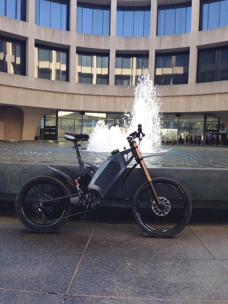

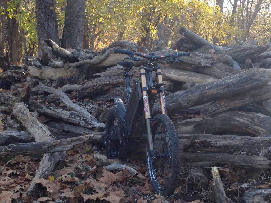

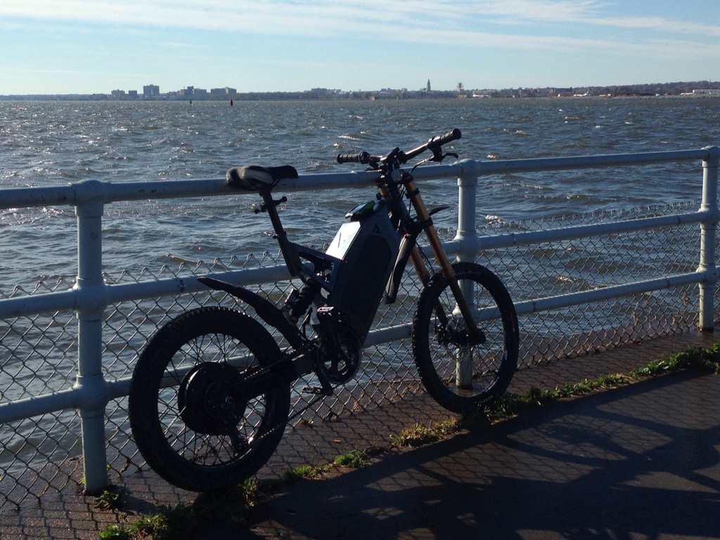

A few pics from my ride

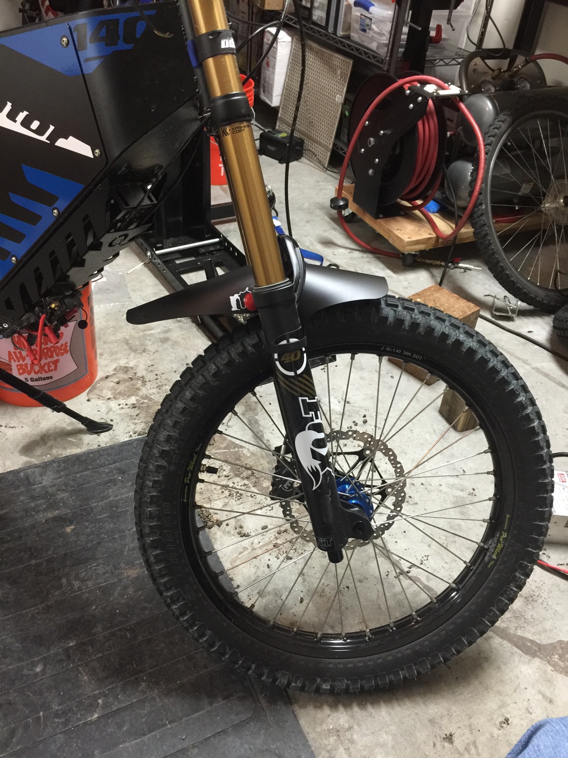

Good question. It caught about 80% of mud. The other 20% was on lowest part of my jacket and seat. I would love to get the quigly ones but too expensive. You suggest any?
Great build and pics Drew. Looks like you are getting some good fall riding in. Don't know the monument, if I had to guess, its George Washington. I wonder what he would think of your build? BTW, let me know how many miles you get with your Avids before changing the pads. I am planning to run Avids on my next build.

I just picked up a set of Hope Tech 3 V4 brakes for the Beta for $354 shipped from Merlin cycles. Pretty good deal I think. I really wanted the Magura MT5 or MT7 with mineral oil instead of DOT but I have some Hope V4 rotors that need a good mate. I had to file the heck out of my MT7 to get the Hope V4 rotors to fit my Raptor and I don't want to do that again.
Drew, you inspired me to put on a Mucky Nutz Fat Face XL that I had laying around forever. I took it for a run and it worked pretty well and it is pretty cheap. I'd dare to say a bit ugly though. I'll post up a picture later when I can resize. I really wish the forum had a good easy way to upload from an iPhone...

Rix, Forgot to mention, yes it's Washington monument. I think it was really funny thought about he would think of build.
