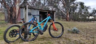

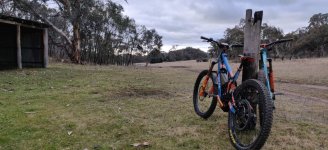

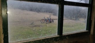

Quick ride report. Took the LMX64 out and my BBSHD converted Yeti to the top of one of the bigger hills we have here locally.
Both bikes took the 800m of vertical climb, with some 30%+ sections, with ease. We stopped a couple times after each big climb to let the motors cool.
Overall highly impressed what the LMX (and the Bafang with SRAM Eagle 50t) can climb.
