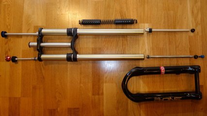

This weekend I serviced my old RST fork
I have 1500km on it.
The dust seals where nasty, stuffed with dirt even tho I never used the bike in the mud or wet. I had to scrape it of from the inside.
The fork oil was ok, not to dirty, I was able to drain around 180cc, so thats how much you will need when putting in new.
And here is the shiny stuff inside :)
I used MoS2 grease (NLGI2) to lube the tubes/spring and seals. The fork felt a bit smoother after the cleanup.
But I came to conclusion that no matter how much you grease up the fork, it has to much friction, even without spring and oil I felt the drag when compressing/decompressing. My 888s feels like butter in comparison.
When I put the spring in, well, it is just to hard. But I guess you need to have that when the fork has limited adjustments(like Spring Preload/Volume Adjust) and need to fit for all kind of people.

Could we discuss this fork assembly.
How do you get it apart? I assume you remove the 2 screws at the bottom of the lower legs to pull the lower legs off what they're calling the crown assembly. Do the top caps unscrew?
So one side has the spring, and the other side has the damping? Is there oil in both sides, or only the damping side? Can you put oil in both sides?
Is the spring side only for preload.

I unscrewed everything on top(dial valves and caps), drained the oil, than unscrewed everything on the bottom, and separated the stanchions from the tubes. It is pretty basic and straight forward.
Yes, one side is spring only(preload), other is oil only, you cannot put oil on the spring side because it is not a tight seal.
Rix, no cartridge, the photo shows everything whats inside. I never worked with fork oil so I have no idea what viscosity it was, sorry. Think it was a tad thicker than my 2,5W Motorex I put in for the compensation of the stiffness.
No oil in the world will help this fork. It has to much stiction on the seals, I don't think the valving would help either. I red about this fork on the internet and no one have a good word about it :) I am surprised that it cost so much brand new.

YAH QMS, why didn't you recommend WP forks before we bought the 888s? :evil: I wonder if some poly impregnated SKF Seals would be less sticky? Just the same, the 888s are a nice and better up grade. The 2.5w Motorex is good shit. I used that for my forks on my XCF 450. We will see how I like the Hippie Tech valving when I get it done. Probably will be a January project.
Theo, try the Redline when you get your Bomber. I am of the same opinion as Allex, wont help with the stiction issue. Could be wrong though. The RSTs have nothing, can't eve play musical Shim stacks with them. So let us know when you know.
