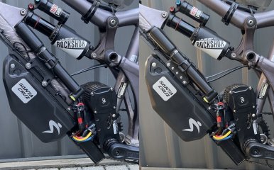

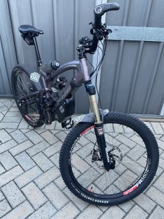

Not a build from scratch , rather a rebuild with a few new parts that make a big difference . The biggest change is the battery . This is the battery I've been searching for at a reasonable price - smaller size , lighter weight , hard case , 52 volt , 50A continuous discharge , tested to EN62133-2-22017 , Samsung 21700 cells . It's dimensions are L 279mm (11") - W 89mm (3.5") - H 107mm (4.2") and weight is 2.9 Kg (6.4 lbs) including bracket . Very little voltage sag , which means a lot more range than my previous 36 volt battery of the same 508 Ah capacity .

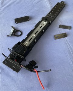

While the battery change was happening I took off all of the parts that I'd previously made and either remade or modified them all and painted them in Hammertone black (yep , etch primed first) . The largest piece is the battery , controller and pump mount which also helps tidy the wiring and cabling up a lot . The other pieces are the display mount , controller wire cover and a couple of bits that bolt over the seat rails to keep the saddle bag away from the seat post clamp when the post is dropped .

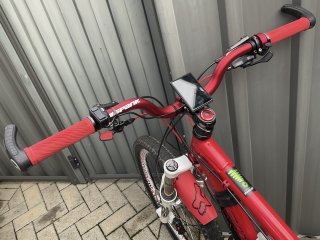

I purchased a CYC 1 to 1 cable for the display (no throttle for me) and got rid of a plug that I don't use . The cable is listed for the Photon on their website but it fits the X1 Stealth plug and play and is a little bit shorter .

Did a bit of fiddling around and fabricated a better way to mount the pump . As a bonus it hides the wiring that goes to the display more than before and it feels more solid .

Everything is going well on both bikes , voltage sag is minimal and range has been greatly improved with the 52 volt batteries . Motors , controllers and batteries are above chainring height so ground clearance isn't an issue on the groomed trails that we all ride on these days . The batteries are rock solid with no movement whatsoever and are nice and easy to remove .
